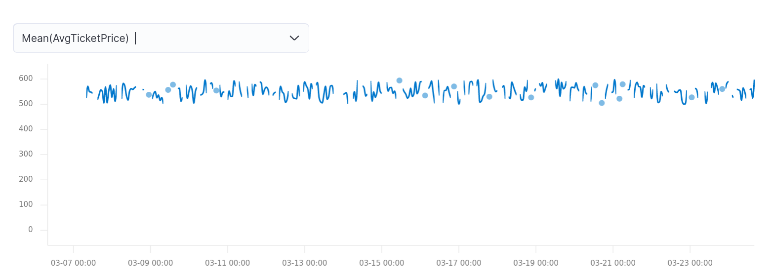

When I use the machine learning feature I find that Index filter does not seem to work on Data Frame Analytics.
I set the filter AveTicketPrice:500 to 600 on kibana_sample_data_flights and saved this search
When I try to use this search in Anomaly Detection, the filter works fine.
But I noticed that when this search was selected in Data Frame Analytics, the filter didn't take effect and the data outside the price range still appeared in the data display.
