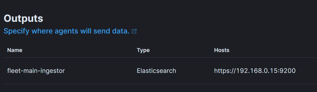

Hello Stephen,
Thanks for the help. I did leave out some crucial details.
to answer your questions:
  1. 8.19.6
  2. Elasticsearch kibana and fleet are running in 3 VMs (vbox). these instances have their own (static) LAN ip address
  3. No, i can install an agent but cannot get it to enroll in fleet. Meaning i cannot add the fleet integration to the agent to upgrade the agent to a fleet server
  4. Yes, i’m using my own self-signed CA and certificates for transport & http layer on elasticsearch. Kibana also uses a self signed certificate.
  5. No the agent/fleet server is (going to) run(ning) on the fleet VM
  6. Yes:

ssl.key: /path/to/cert_key
How do you specify this if your agents are a mix of windows and unix?
Given that the cert is IP based, how can one cert fit all?
Or is this the fleet cert that needs to be specified here?
