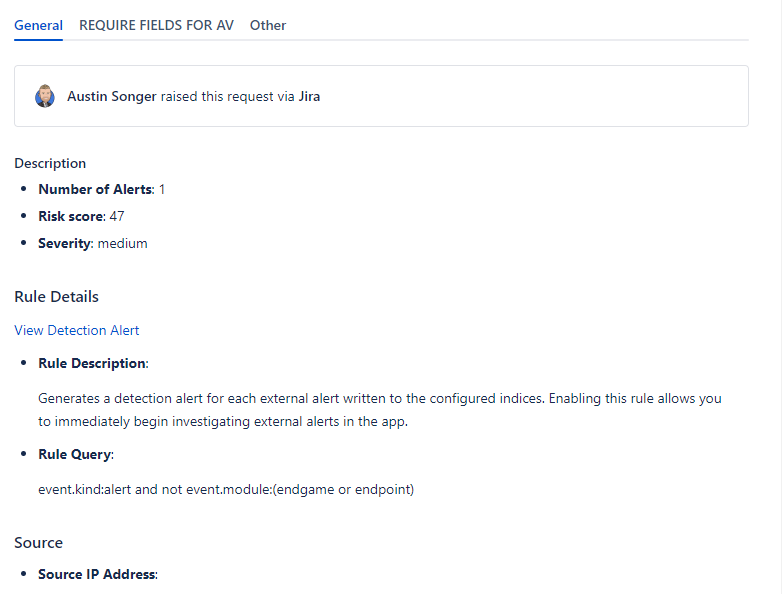

If you use JIRA Wiki Rendering parameters and I never get broke links like the following screenshot. Also I load pre-built rules and then I duplicate all of the rules and then delete the pre-built rules under Elastic Rules. So it will appear like the following. Elastic Rules (0) Custom Rules (480)
Jira has their own “markdown” variant, they also probably do some “linkification”, it also probably has some “issues”, and it can probably/usually be worked around by not using auto-linkification, but the specific link format prescribed by the rendering engine.
