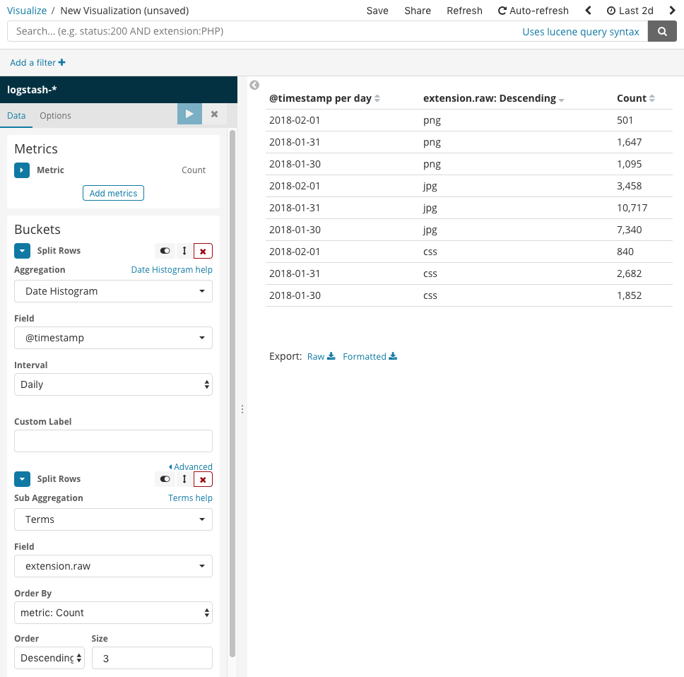

The Date histogram aggregation in Elasticsearch doesn't support size the way the Terms agg does, instead you have to filter the range you are querying.
To do this in Kibana, you'll want to use the time filter at the top right of Kibana to control the time range being displayed.

If you know the start, you can use the Date Math aggregation instead of the Date Histogram, and do something like this:
32
This will give you the last 2 days, and only the last 2 days, rounded to the nearest day. The problem with that is then you can't control the range, so if you look at it at 12:01am, it'll show the current, new day, with almost no data, and the data will change depending on when you look at it/run the query. But that will give you the grouping you want, at least for the immediate 2 day range.
I don't know the last @timestamp per day that will be available in my data in advance
I don't understand what you mean by that. Even if the data is coming in after the fact, seeng the historical data seems like it would smooth over that problem. I probably just don't fully understand your data and what you're trying to do with it. It sounds like this is more or less what you want though:
