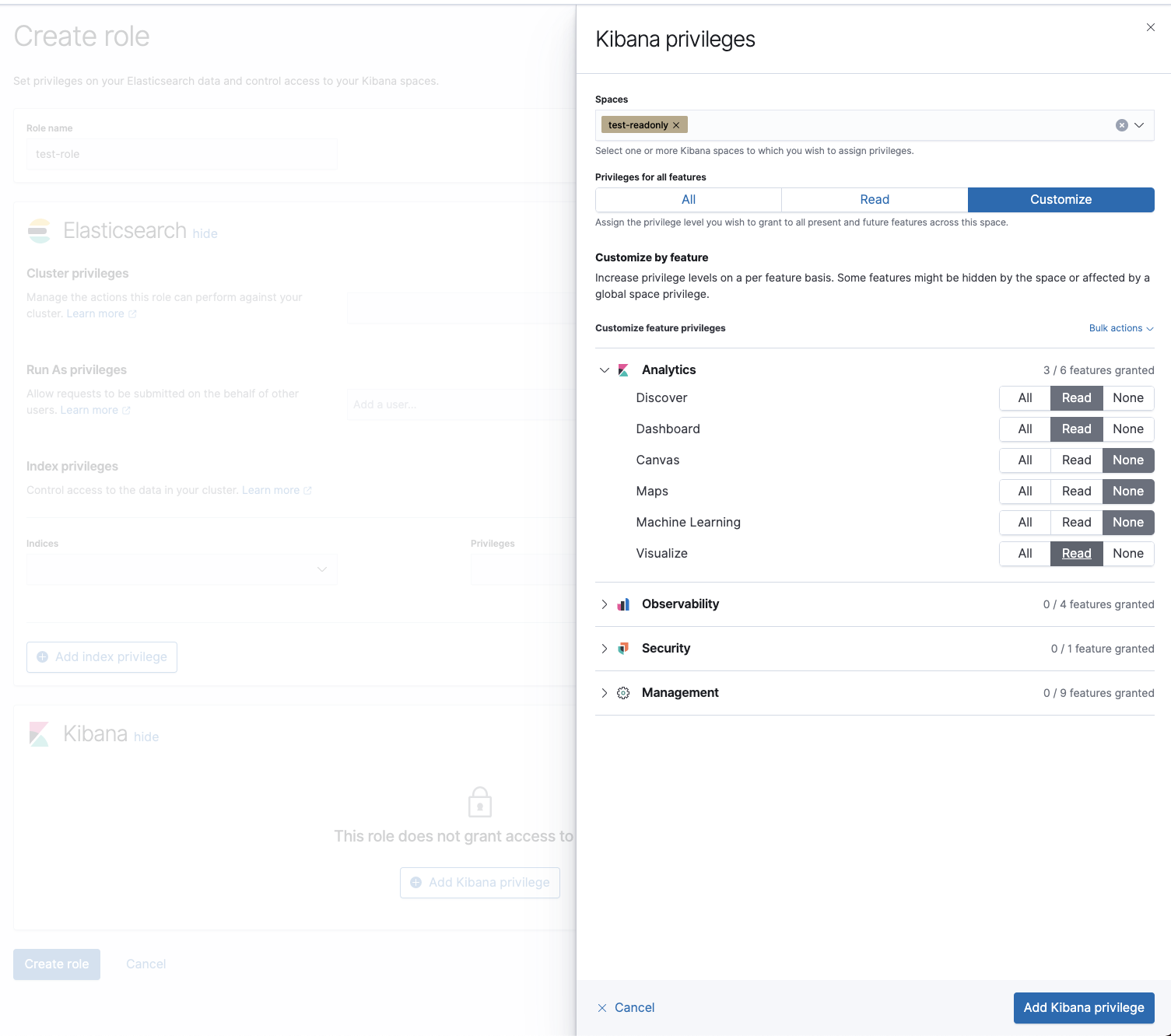

Hello,
We have created a new space just for read only user to access - Visibility in Analytics->Dashboard, Discover and Visualise.
Then we created a new role within new space only, with read only privileges again for Analytics->Dashboard, Discover and Visualise. We did not assigned any Cluster privileges as we are just testing RBAC at this stage.
And then we created a new user and assigned new role to it.
For some reason when the new user logins to Kibana it can change the space to 'default' one with full access to everything.... On top of that within new space Management menu is available (along with Analytics one) with all submenus and again full access to write/read etc.
Is this a bug or we are doing something wrong?
We are running ELK 7.11 on k8s (self managed) on GCP.
Thanks,
Bog

If still trouble please paste a complete view of the role creation. Notice I only have the one space then I went into that a specifically set the priviliges, it is kinda weird you set up what is available in the space under manage space then you refine it / do it again in the Kbana privileges during role creation.

Rolle setting:

Can you show us two additional things:
  1. the raw role definition
  2. the user's privileges
For the role definition, go into Dev Tools / Console in Kibana (when logged in as your administration user, e.g. elastic) and run
GET /_security/role/test-role
That will show us exactly what this role can do, and will show us if something is out of place.
For the user's privileges, go into Dev Tools / Console as the test user (assuming that is possible - it sounds like in your case the user has access to Dev Tools, even though you don't want it to), and run
GET /_security/_authenticate
and
GET /_security/user/_privileges
Something isn't quite right here, and hopefully that information will pinpoint what it is, and then we can try and work out why it got into that state.

As elastic user:
      "test-role" : {
        "cluster" : [ ],
        "indices" : [ ],
        "applications" : [
            "application" : "kibana-.kibana",
            "privileges" : [
              "feature_discover.read",
              "feature_dashboard.read",
              "feature_visualize.read"
            "resources" : [
              "space:test-readonly"
        "run_as" : [ ],
        "metadata" : { },
        "transient_metadata" : {
          "enabled" : true
As test user and after switching to default space (to access Dev Tools):
          "username" : "test",
          "roles" : [
            "test-role",
            "superuser"
          "full_name" : "",
          "email" : "",
          "metadata" : { },
          "enabled" : true,
          "authentication_realm" : {
            "name" : "default_native",
            "type" : "native"
          "lookup_realm" : {
            "type" : "native"
          "authentication_type" : "realm"
Strange why there is superuser role?
      "cluster" : [
        "all"
      "global" : [ ],
      "indices" : [
          "names" : [
          "privileges" : [
            "all"
          "allow_restricted_indices" : true
      "applications" : [
          "application" : "*",
          "privileges" : [
          "resources" : [
      "run_as" : [
Full privileges??
You don't happen to have anonymous access turned on in Elasticsearch do you?
Hmm I think we have?!
Here is our ES config:
cluster.name=csv-test
discovery.seed_hosts=es-cluster-0.elasticsearch
cluster.initial_master_nodes=es-cluster-0
ES_JAVA_OPTS=-Xms512m -Xmx512m
xpack.security.enabled=true
xpack.security.http.ssl.enabled=true
xpack.security.http.ssl.keystore.path=certs/http.p12
xpack.security.http.ssl.client_authentication=optional
xpack.security.authc.api_key.enabled=true
xpack.security.authc.token.enabled=false
xpack.security.authc.anonymous.username=agent
xpack.security.authc.anonymous.roles=superuser
ELASTIC_USERNAME=elastic
node.store.allow_mmap=false
xpack.security.transport.ssl.enabled=true
xpack.security.transport.ssl.verification_mode=certificate
xpack.security.transport.ssl.keystore.path=certs/elastic-certificates.p12
xpack.security.transport.ssl.truststore.path=certs/elastic-certificates.p12
That explains it then.
One of the surprising features of anonymous access in Elasticsearch is that the roles listed in xpack.security.authc.anonymous.roles are added to every user, not just the anonymous user.
It is more accurate to think of them as "global roles" rather than "anonymous roles". I'm afraid that you will not be able to implement role based access control while also granting the superuser role to every user.
@TimV Thanks I learn something new everyday, put that in my knowledge base.
Tanks Guys for the help.
I have disabled xpack.security.authc.anonymous.roles and now roles work as expected.
