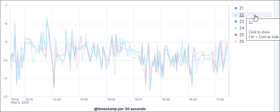

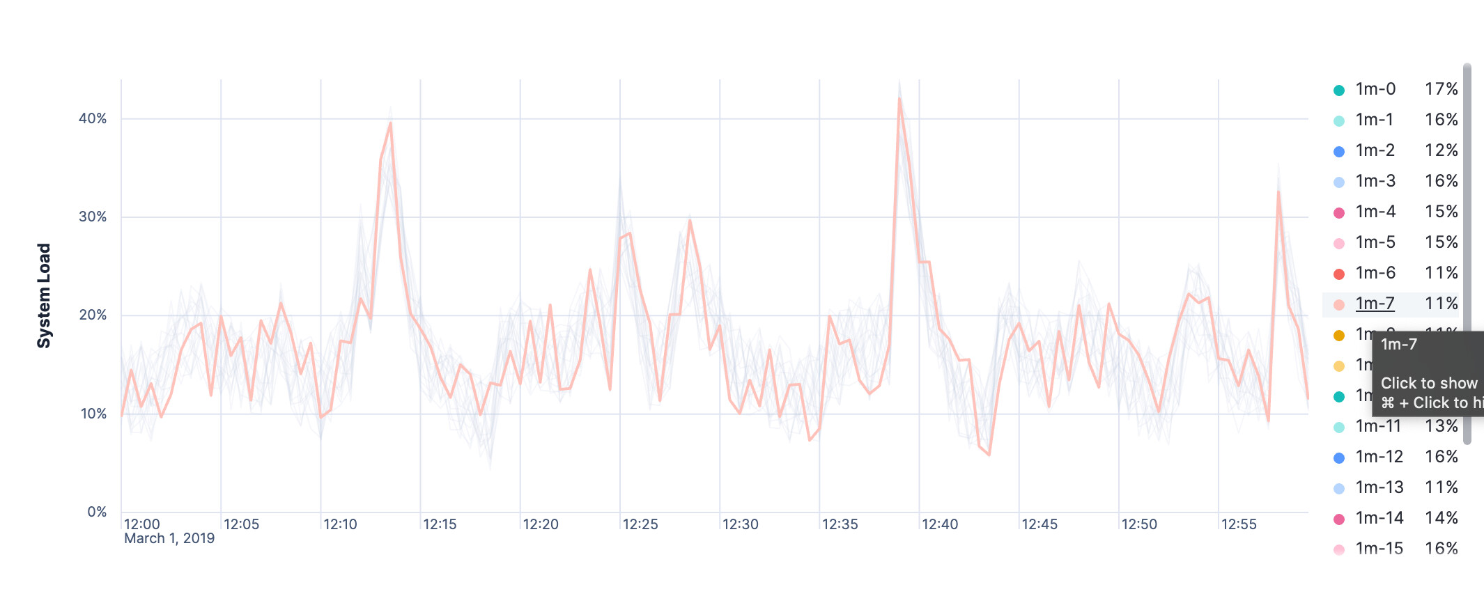

I would like to ask the designers of the new "vibrant color palette", if they ever tested it with Lens visualizations? Very useful function of highlighting the line when hovering it in legend, works now only for 5 of 10 standard colors! The first color of the color pairs has the same color, as the second one, when unhighlighted.
Please try to find the line "Z2", which is highlighted via legend:
The same story is for Z4 and Z6.

Good morning Alexander,
thank you for your feedback, you are absolutely right with your concern and we are actively exploring a quick solution for this.
Unfortunately, one down-side of having a lighter and brighter color palette is that it comes with a few limits on light mode. Our approach of proposing a set of color with less variety but more consistency comes with a series of effect that we need to control.
While we work on a solution, I wanted to mention that this interaction works way better in dark mode, I know this doesn't fix it but maybe this could give you a temporary alternative
Happy to help if I can, have a good day!

Hello again Alexander, just wanted to give you a quick update in order to share with you what is coming to fix the issue
We took the chance to fix a couple of details that we wanted to tackle for a while and the ending results is not only an adjustment of colors but a proper improvement of the whole hover effect.

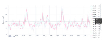

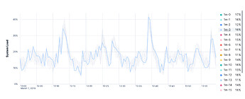

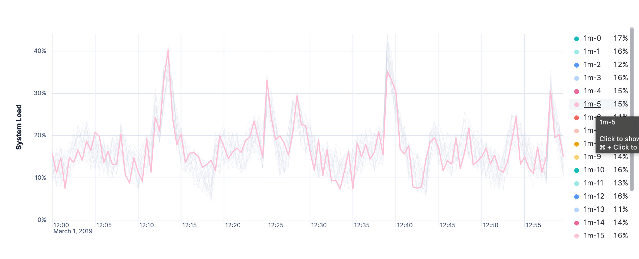

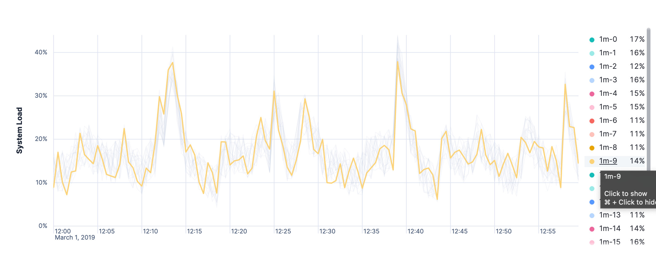

As you can see in the following images and video, the light shades of the palette are way more visible and clearly identifiable. There are still improvements that can be considered but we believe this will be a good update
May-07-2025 14-42-08
We hope this can be helpful and again thank you for your feedback!
Giovanni

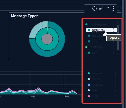

This is also an issue on the Dark theme (based on my system being dark theme).
Good afternoon Eric, the issue you are experiencing is not related to the colors themselves but to a inconvenience happening when the light/dark mode is applied according to system settings. If you pick Dark mode, for instance, everything should work fine.
There is already a PR implemented that will fix this!
