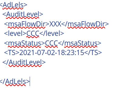

mrunalini
(Mrunalini Sinnarkar)
July 2, 2021, 2:23pm
12
Sorry xml Input not pasted correctly so added image:
