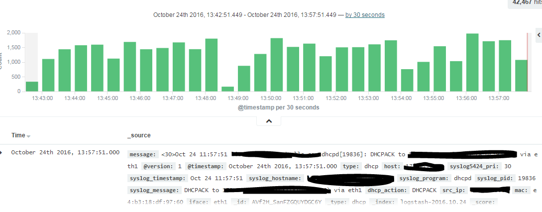

I adjusted the time to my timezone but it still don't work ! the @timestamp still has 2 more hours than the time in the log.
EDIT: by puting Etc/GMT+0 It works but Europe/Paris doesn't have the good time. If I want to visualize the last 15 minutes, I see the last 15 minutes but 2 hours ago..
Is "Oct 24 13:01:59" in UTC+2? What's stored in ES for that event, i.e. what's the raw @timestamp value? You can find it in Kibana on the JSON tab if you expand the message in the Discover view.

That's not what the @timestamp fields looks like. Where did you get that from? Anyway, 1477315740000 is 2016-10-24 13:29:00 UTC. Your log files are UTC+2 so if they contain 13:29:00 the value stored in ES should be 11:29:00.

Well this is what I get when I expand a message and click on JSON and search for the @timestamp field.

This is the part I'm interested in:
    "@timestamp": "2016-10-24T10:57:47.396Z",
So:
"@timestamp": "2016-10-24T13:36:20.000Z"
And:
  "fields": {
    "@timestamp": [
      1477316180000
Okay. Your date filter is broken since it doesn't adjust the timezone of the parsed timestamp to UTC. The filter defaults to the system's timezone, but you can override that with the date filter's timezone. In your case I suppose timezone => "Europe/Paris" would be correct.
