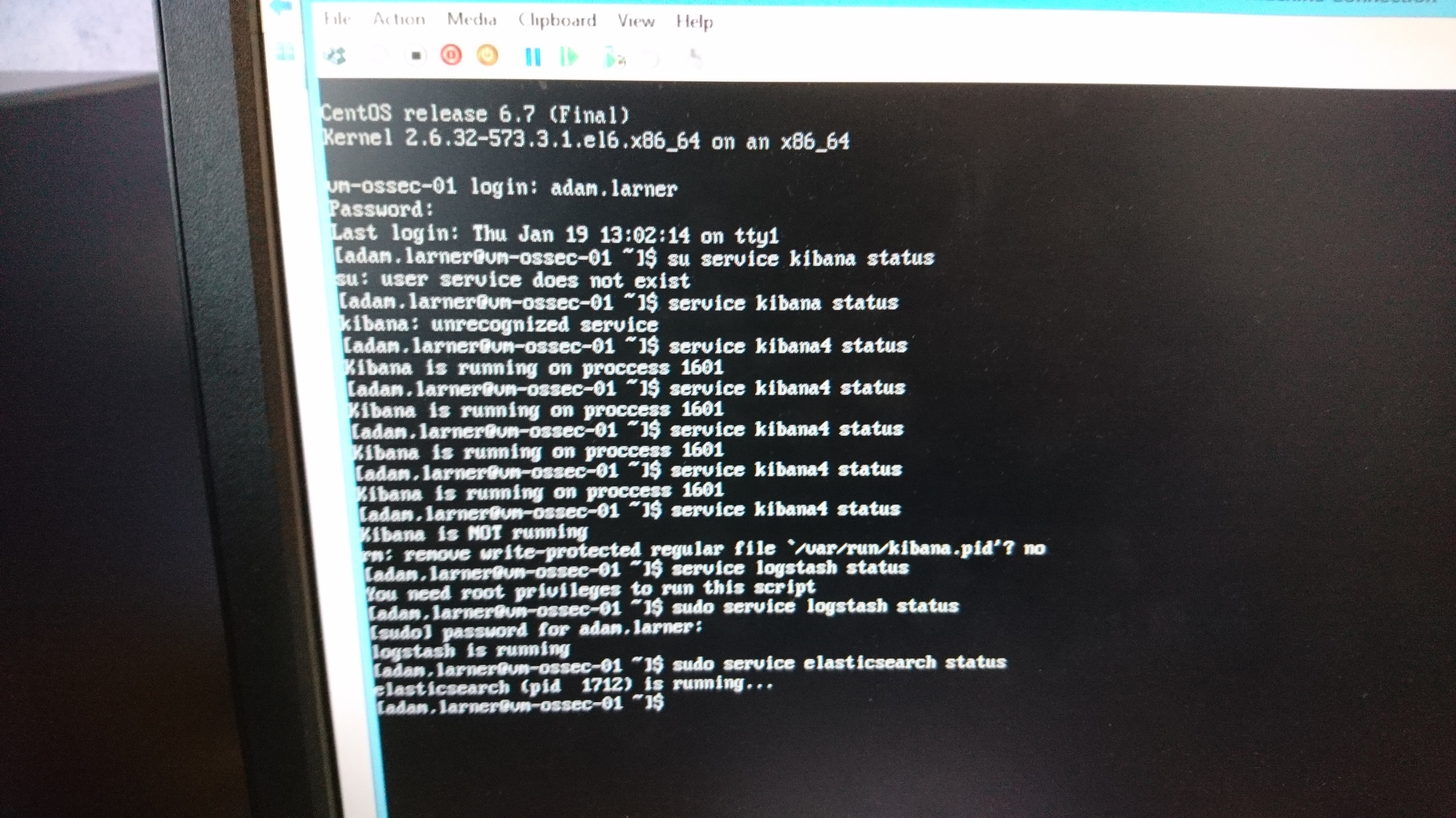

Kibana is NOT running/working
Kibana says its running but then after 30 mins stops.
We are running this on a VM,
It has 16gb ram and 10 Virtual Processors Ive had people say that its because of a garbage collector so its heavy on the ram etc.. obviously 16gb is overkill and it still doesn't want to run.
The OSSEC report however still works. We are still getting all reports and functionality but its kibana that doesn't work and i am not familiar with it.

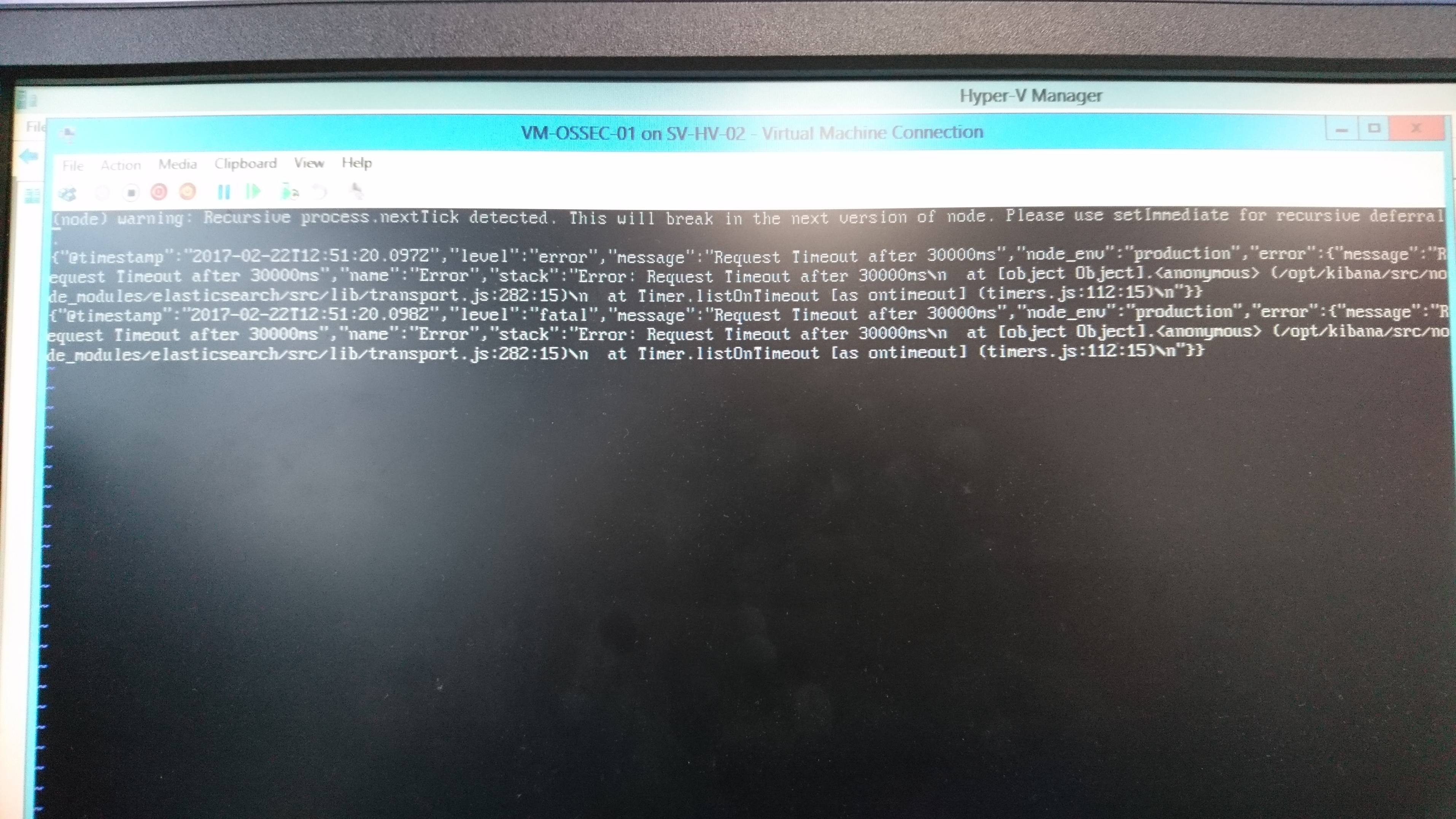

Run Kibana in quiet mode and provide the output:
./kibana -q -l /tmp/kibana.out

Once you have ES started can you run:
  1. free -m
  2. ulimit -a
  3. Start Kibana with sudo
sudo ./kibana
