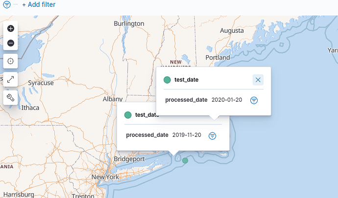

Tested in 7.13 (I can try later in 7.11) the following steps
  1. Create some sample data with your formatter, etc
PUT test_date

      "processed_date": {
        "type": "date",
        "format": "yyyy/MM/dd HH:mm:ss.SSSZZ||yyyy/MM/dd HH:mm:ss.SSS||yyyy/MM/dd"
POST test_date/_doc
  "location": [ -71.34, 41.12 ] ,
  "processed_date": "2019/11/20 00:00:00.000"

  1. Created the index pattern
  2. Created a new map with the data layer and everything seems fine
Have you tried Kibana field formatter in the index pattern? You can format the date the way you want it represented, for example:
... and Maps will honor that setting
Hope it helps!
This is a regression in 7.11, [Maps] Tooltips with timestamp appear as epoch · Issue #95072 · elastic/kibana · GitHub, that has been resolved in 7.12 and higher versions, [Maps] fix tooltips with timestamp appear as epoch by nreese · Pull Request #95106 · elastic/kibana · GitHub. You will need to upgrade to resolve the issue.
