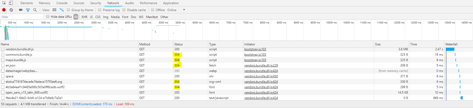

Hey @raulk89, would you mind capturing a HAR of your network traffic so we can determine if a firewall or a certain network configuration is causing this behavior to occur?
To do so, using Chrome if you right-click in Kibana and select "Inspect" this will open up the Chrome Dev Tools. Once these are open, if you refresh the page which is displaying the map. After the page has loaded and you're viewing the error, if you switch back to your Dev Tools, and select the Network tab. In the network tab, if you right-click on any of the requests listed over to the left, you'll see an item in the context menu which says "Save all as HAR with content". After saving this file locally, if you could create a GitHub issue here it will help us diagnose further:

One thing I noticed from console log though:
Refused to execute inline script because it violates the following Content Security Policy directive: "script-src 'unsafe-eval' 'self'". Either the 'unsafe-inline' keyword, a hash ('sha256-SHHSeLc0bp6xt4BoVVyUy+3IbVqp3ujLaR+s+kSP5UI='), or a nonce ('nonce-...') is required to enable inline execution.
bootstrap.js:10 ^ A single error about an inline script not firing due to content security policy is expected!
Network tab had a few 304 (most were 200):
Regards
Raul
