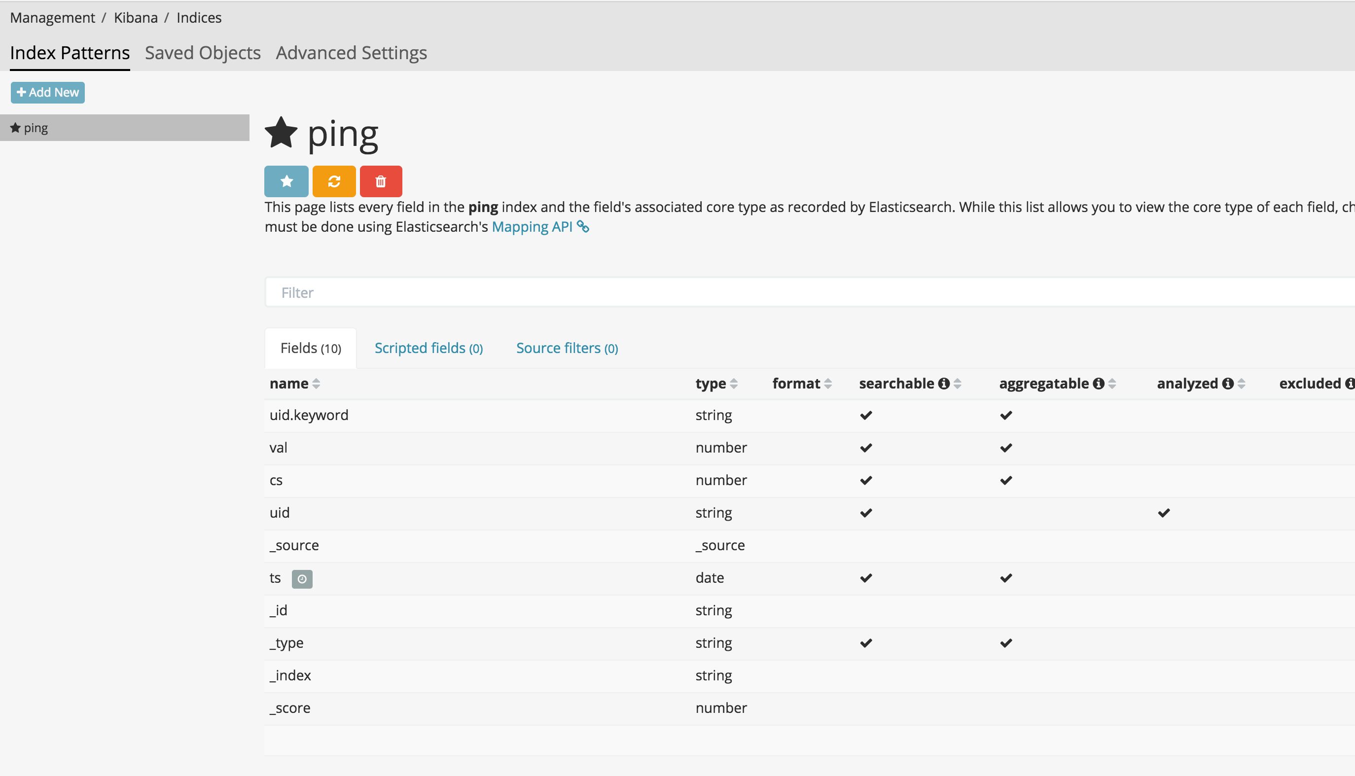

We can see a timestamp with time 22:15 in it. Next, I'll be looking at the discover tab in kibana to discover that it cannot find any results what-so-ever. Note that I am looking 5 hours back and the time of running was 22:48 on the same date.
The visualisations also do not work and I am wondering why. I have added the data to the index pattern.
What am I missing?
I am running ELS version: 5.1.1 that came with the developer tutorial of elasticsearch.
I've later added much more data. The initial blob was about 200 items and later I've sent it about 2200 more. After doing that and waiting 5 minutes I now do see data appear in kibana. Can this explain what I am seeing?
