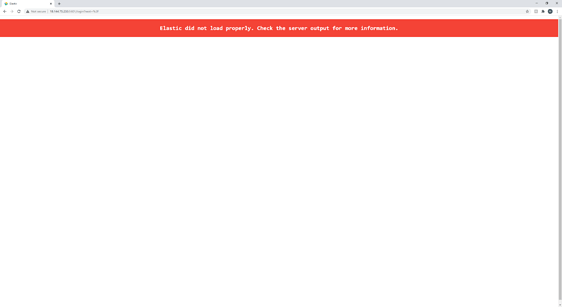

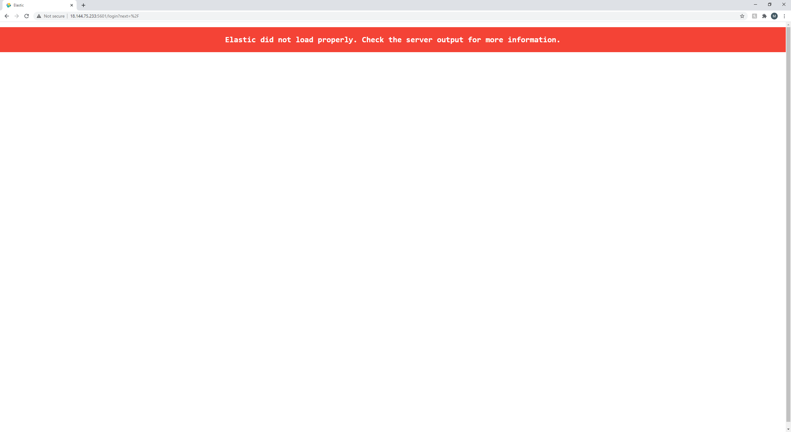

1) xpack.reporting.enabled: false
[ec2-user@ip-172-31-24-126 kibana]$ yarn start --run-examples
yarn run v1.22.10
$ node scripts/kibana --dev --run-examples
[2020-12-16T21:43:30.931Z][INFO ][plugins-service] Plugin initialization disabled.

I've try restarting everything again and now I receive a response back when I goto instance_ip:5601, but I still get an error:
[ec2-user@ip-172-31-24-126 kibana] yarn start --run-examples yarn run v1.22.10 node scripts/kibana --dev --run-examples
[2020-12-16T22:19:27.085Z][INFO ][plugins-service] Plugin initialization disabled.
[2020-12-16T22:19:27.148Z][WARN ][savedobjects-service] Skipping Saved Object migrations on startup. Note: Individual documents w ill still be migrated when read or written.
no-base-path ====================================================================================================
no-base-path Running Kibana in dev mode with --no-base-path disables several useful features and is not recommended
np bld log [22:19:30.828] [info][@kbn/optimizer] initialized, 74 bundles cached
np bld log [22:19:30.836] [warning][@kbn/optimizer] only building [v7dark,v7light] themes, customize with the KBN_OPTIMIZER_ THEMES environment variable
np bld log [22:19:36.343] [info][@kbn/optimizer] starting worker [23 bundles]
np bld log [22:19:36.344] [info][@kbn/optimizer] starting worker [23 bundles]
watching for changes (8015 files)
server log [22:19:54.361] [info][plugins-service] Plugin "visTypeXy" is disabled.
server log [22:19:54.404] [info][plugins-service] Plugin "reporting" is disabled.
server log [22:19:55.991] [info][plugins-system] Setting up [106] plugins: [usageCollection,xpackLegacy,telemetryCollection Manager,telemetry,telemetryCollectionXpack,kibanaUsageCollection,taskManager,licensing,globalSearch,globalSearchProviders,code,se curityOss,newsfeed,mapsLegacy,kibanaLegacy,routingExample,translations,share,legacyExport,embeddable,uiActionsEnhanced,expression s,charts,esUiShared,bfetch,data,home,observability,console,consoleExtensions,apmOss,searchprofiler,painlessLab,grokdebugger,manag ement,indexPatternManagement,advancedSettings,fileUpload,savedObjects,visualizations,visTypeVislib,visTypeVega,visTypeTimeseries, visTypeTimeseriesEnhanced,visTypeTimelion,features,licenseManagement,dataEnhanced,watcher,canvas,visTypeTagcloud,visTypeTable,vis TypeMarkdown,visTypeMetric,tileMap,regionMap,mapsOss,lensOss,inputControlVis,graph,timelion,dashboard,embeddableExamples,dashboar dEnhanced,visualize,stateContainersExamples,searchExamples,discover,discoverEnhanced,savedObjectsManagement,spaces,security,saved ObjectsTagging,maps,lens,lists,encryptedSavedObjects,dashboardMode,cloud,upgradeAssistant,snapshotRestore,fleet,indexManagement,r ollup,remoteClusters,crossClusterReplication,indexLifecycleManagement,enterpriseSearch,ml,beatsManagement,transform,ingestPipelin es,eventLog,actions,alerts,triggersActionsUi,stackAlerts,securitySolution,case,infra,monitoring,logstash,apm,alertingExample,upti me,bfetchExplorer]
server log [22:19:56.048] [info][plugins][taskManager] TaskManager is identified by the Kibana UUID: 64f54d40-ee3e-499b-9e9 5-f5dfe88ec3d8
server log [22:19:57.558] [warning][config][plugins][security] Session cookies will be transmitted over insecure connection s. This is not recommended.
server log [22:19:59.509] [info][monitoring][monitoring][plugins] config sourced from: production cluster
server log [22:20:01.899] [info][savedobjects-service] Waiting until all Elasticsearch nodes are compatible with Kibana bef ore starting saved objects migrations...
server log [22:20:02.588] [info][savedobjects-service] Starting saved objects migrations
server log [22:20:03.036] [info][savedobjects-service] Creating index .kibana_1.
server log [22:20:03.053] [info][savedobjects-service] Creating index .kibana_task_manager_1.
server log [22:20:04.121] [info][savedobjects-service] Pointing alias .kibana to .kibana_1.
server log [22:20:04.495] [info][savedobjects-service] Pointing alias .kibana_task_manager to .kibana_task_manager_1.
server log [22:20:04.803] [info][savedobjects-service] Finished in 1797ms.
server log [22:20:04.855] [info][savedobjects-service] Finished in 1802ms.
server log [22:20:05.271] [info][plugins-system] Starting [106] plugins: [usageCollection,xpackLegacy,telemetryCollectionMa nager,telemetry,telemetryCollectionXpack,kibanaUsageCollection,taskManager,licensing,globalSearch,globalSearchProviders,code,secu rityOss,newsfeed,mapsLegacy,kibanaLegacy,routingExample,translations,share,legacyExport,embeddable,uiActionsEnhanced,expressions, charts,esUiShared,bfetch,data,home,observability,console,consoleExtensions,apmOss,searchprofiler,painlessLab,grokdebugger,managem ent,indexPatternManagement,advancedSettings,fileUpload,savedObjects,visualizations,visTypeVislib,visTypeVega,visTypeTimeseries,vi sTypeTimeseriesEnhanced,visTypeTimelion,features,licenseManagement,dataEnhanced,watcher,canvas,visTypeTagcloud,visTypeTable,visTy peMarkdown,visTypeMetric,tileMap,regionMap,mapsOss,lensOss,inputControlVis,graph,timelion,dashboard,embeddableExamples,dashboardE nhanced,visualize,stateContainersExamples,searchExamples,discover,discoverEnhanced,savedObjectsManagement,spaces,security,savedOb jectsTagging,maps,lens,lists,encryptedSavedObjects,dashboardMode,cloud,upgradeAssistant,snapshotRestore,fleet,indexManagement,rol lup,remoteClusters,crossClusterReplication,indexLifecycleManagement,enterpriseSearch,ml,beatsManagement,transform,ingestPipelines ,eventLog,actions,alerts,triggersActionsUi,stackAlerts,securitySolution,case,infra,monitoring,logstash,apm,alertingExample,uptime ,bfetchExplorer]
server log [22:20:09.105] [info][plugins][watcher] Enabling Watcher plugin.
server log [22:20:09.128] [info][kibana-monitoring][monitoring][monitoring][plugins] Starting monitoring stats collection
[BABEL] Note: The code generator has deoptimised the styling of /home/ec2-user/repos/kibana/x-pack/plugins/security_solution/ser ver/utils/beat_schema/fields.ts as it exceeds the max of 500KB.
server log [22:20:39.056] [info][listening] Server running at http://0.0.0.0:5601
server log [22:20:45.945] [info][server][Kibana][http] http server running at http://0.0.0.0:5601
[BABEL] Note: The code generator has deoptimised the styling of /home/ec2-user/repos/kibana/x-pack/plugins/canvas/server/templat es/pitch_presentation.ts as it exceeds the max of 500KB.
server log [22:20:50.537] [error][ml][plugins] Error Initializing jobs {"name":"TimeoutError","meta":{"body":null,"statusCo de":null,"headers":null,"meta":{"context":null,"request":{"params":{"method":"POST","path":"/.kibana/_search","body":"{"seq_no_p rimary_term":true,"query":{"bool":{"filter":[{"bool":{"should":[{"bool":{"must":[{"term":{"type":"ml-job"}}] ,"must_not":[{"exists":{"field":"namespace"}}]}}],"minimum_should_match":1}}]}}}","querystring":"size=0&from=0&rest_tot al_hits_as_int=true","headers":{"user-agent":"elasticsearch-js/7.10.0 (linux 4.14.209-160.335.amzn2.x86_64-x64; Node.js v14.15.2) ","x-elastic-product-origin":"kibana","content-type":"application/json","content-length":"198"},"timeout":30000},"options":{"maxR etries":0,"ignore":[404]},"id":21},"name":"elasticsearch-js","connection":{"url":"http://localhost:9200/","id":"http://localhost: 9200/","headers":{},"deadCount":2,"resurrectTimeout":1608157370536,"_openRequests":18,"status":"dead","roles":{"master":true,"dat a":true,"ingest":true,"ml":false}},"attempts":0,"aborted":false}},"isBoom":true,"isServer":true,"data":null,"output":{"statusCode ":503,"payload":{"statusCode":503,"error":"Service Unavailable","message":"Request timed out"},"headers":{}}}
server log [22:20:50.549] [error][index][plugins][security][session] Failed to check if session index template exists: Requ est Timeout after 30000ms
server log [22:20:50.563] [warning][kibana-monitoring][monitoring][monitoring][plugins] Error: Request Timeout after 30000m s
at /home/ec2-user/repos/kibana/node_modules/elasticsearch/src/lib/transport.js:397:9
at Timeout. (/home/ec2-user/repos/kibana/node_modules/elasticsearch/src/lib/transport.js:429:7)
at listOnTimeout (internal/timers.js:554:17)
at processTimers (internal/timers.js:497:7)
server log [22:20:50.577] [warning][kibana-monitoring][monitoring][monitoring][plugins] Unable to bulk upload the stats pay load to the local cluster
server log [22:20:50.586] [error][plugins][security][session] Failed to retrieve session index cleanup task: Request timed out
server log [22:20:50.599] [error][plugins][securitySolution][telemetry_events] Error scheduling task, received Request time d out
What do you get with just a normal yarn start without the examples added?
The messages starting with "Creating index .kibana_1." seem to indicate that it can connect to elasticsearch.
But then the message "[error][ml][plugins] Error Initializing jobs" seems to be that it can no longer connect to elasticsearch. Could elasticsearch have gone down between the two messages?

With yarn start I can reach Kibana:
Think that just means at least one of the plugins in /examples/ doesn't work with the current version.
