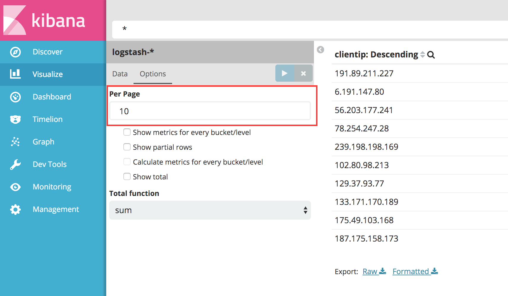

What if i was to create a table using the visualize tab, how could I limit the rows ?
You can use the 'Size' input to control the number of results returned:
If you're using the DataTable visualization, you can also control the number of results that are returned per page:
@Brandon_Kobel gotcha, thank you!
