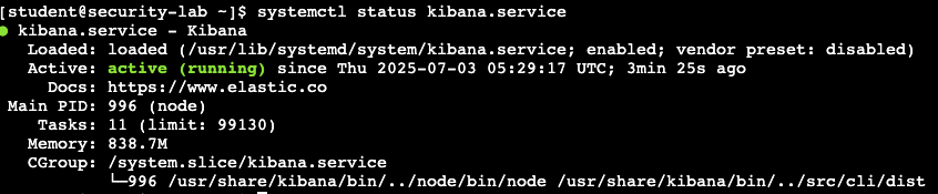

Hello @Tortoise,
Thanks for the information, when I tried running docker ps, I get the response that docker command is not found. Since this is a lab environment hosted in strigo, I think it is directly hosted on the server without a docker. When I run systemctl directly on the server it shows service running.
