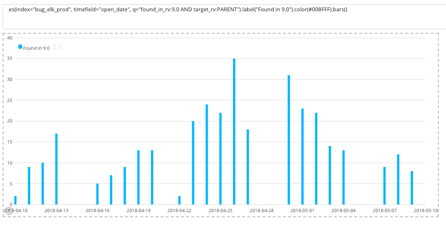

I am on Kibana 6.2.4 and I couldn't get the following Timelion visualization working right.
.es(index="bug_elk_prod", timefield="open_date", q="(found_in_rv: 'AGM 9.0') AND (target_rv:PARENT)").label("Found in AGM 9.0").color(#00BFFF).bars()
The visualization of this query came out as same as my other Timelion visualization - in which q="(found_in_rv: '9.0') AND (target_rv:PARENT)") the value "9.0" is the only difference. Please see the screenshot attached to this discussion.
It seems like the query of 'AGM 9.0' didn't go through. How could I make it right to get the data associated with "AGM 9.0"? Thanks.
Nars
