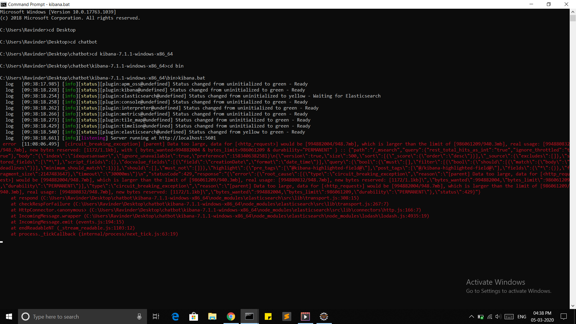

This is what it shows then on my cmd where I started my kibana server.

log   [09:38:18.661] [info][listening] Server running at http://localhost:5601
 error  [11:08:06.495]  [circuit_breaking_exception] [parent] Data too large, data for [<http_request>] would be [994882004/948.7mb], which is larger than the limit of [986061209/940.3mb], real usage: [994880832/948.7mb], new bytes reserved: [1172/1.1kb], with { bytes_wanted=994882004 & bytes_limit=986061209 & durability="PERMANENT" } :: {"path":"/_msearch","query":{"rest_total_hits_as_int":"true","ignore_throttled":"true"},"body":"{\"index\":\"idxquesanswer\",\"ignore_unavailable\":true,\"preference\":1583406382581}\n{\"version\":true,\"size\":500,\"sort\":[{\"_score\":{\"order\":\"desc\"}}],\"_source\":{\"excludes\":[]},\"stored_fields\":[\"*\"],\"script_fields\":{},\"docvalue_fields\":[{\"field\":\"creationDate\",\"format\":\"date_time\"}],\"query\":{\"bool\":{\"must\":[],\"filter\":[{\"bool\":{\"should\":[{\"match\":{\"body\":\"deadlines\"}}],\"minimum_should_match\":1}}],\"should\":[],\"must_not\":[]}},\"highlight\":{\"pre_tags\":[\"@kibana-highlighted-field@\"],\"post_tags\":[\"@/kibana-highlighted-field@\"],\"fields\":{\"*\":{}},\"fragment_size\":2147483647},\"timeout\":\"30000ms\"}\n","statusCode":429,"response":"{\"error\":{\"root_cause\":[{\"type\":\"circuit_breaking_exception\",\"reason\":\"[parent] Data too large, data for [<http_request>] would be [994882004/948.7mb], which is larger than the limit of [986061209/940.3mb], real usage: [994880832/948.7mb], new bytes reserved: [1172/1.1kb]\",\"bytes_wanted\":994882004,\"bytes_limit\":986061209,\"durability\":\"PERMANENT\"}],\"type\":\"circuit_breaking_exception\",\"reason\":\"[parent] Data too large, data for [<http_request>] would be [994882004/948.7mb], which is larger than the limit of [986061209/940.3mb], real usage: [994880832/948.7mb], new bytes reserved: [1172/1.1kb]\",\"bytes_wanted\":994882004,\"bytes_limit\":986061209,\"durability\":\"PERMANENT\"},\"status\":429}"}
at respond (C:\Users\Ravinder\Desktop\chatbot\kibana-7.1.1-windows-x86_64\node_modules\elasticsearch\src\lib\transport.js:308:15)
at checkRespForFailure (C:\Users\Ravinder\Desktop\chatbot\kibana-7.1.1-windows-x86_64\node_modules\elasticsearch\src\lib\transport.js:267:7)
at HttpConnector.<anonymous> (C:\Users\Ravinder\Desktop\chatbot\kibana-7.1.1-windows-x86_64\node_modules\elasticsearch\src\lib\connectors\http.js:166:7)
at IncomingMessage.wrapper (C:\Users\Ravinder\Desktop\chatbot\kibana-7.1.1-windows-x86_64\node_modules\elasticsearch\node_modules\lodash\lodash.js:4935:19)
at IncomingMessage.emit (events.js:194:15)
at endReadableNT (_stream_readable.js:1103:12)
at process._tickCallback (internal/process/next_tick.js:63:19)

And this is what I get at my cmd where I initialized kibana server:
Also as you instructed earlier, I updated my heap size to 2 GB, But still the problem I'm facing remains unsolved.
The logs report that you still have 1gb of heap.
Check the installation guide on how to configure the heap and until the logs show you have 2gb, it's useless to run the same tests.
