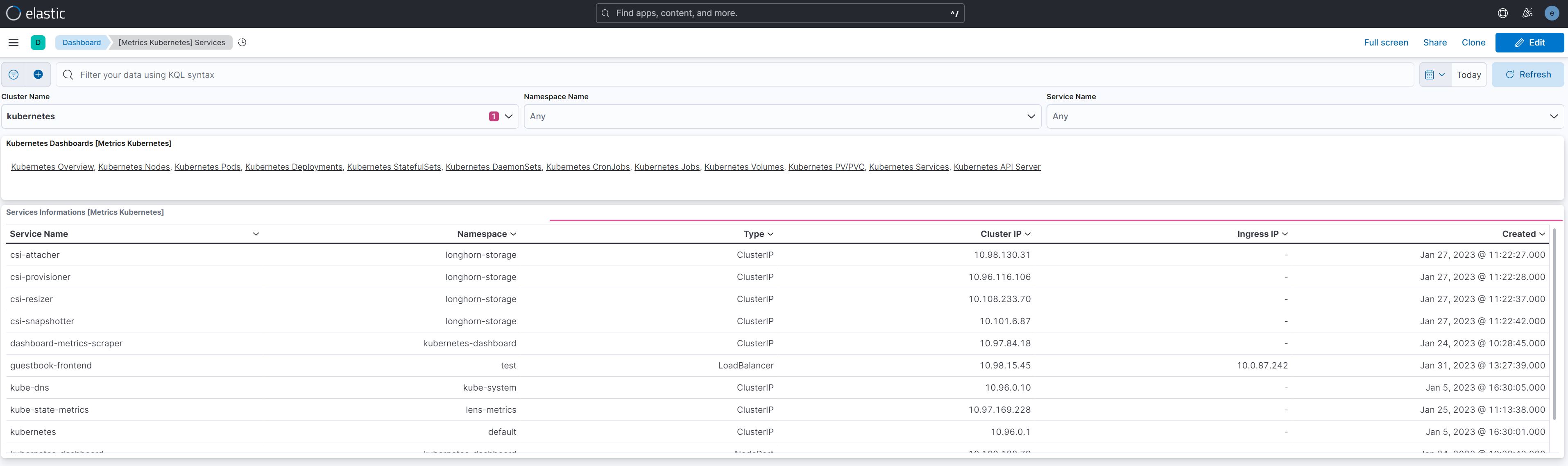

In Kibana, I can see all the Kubernetes Dashboards, but no data from the k8s cluster (metrics and logs) is displayed. Indexes are not displayed in Index Management either.
Below is the log from Elasticsearch and the Deployment file that was installed on the k8s cluster. Deployment is active on the k8s cluster.
I would like to ask for help in solving this problem.
Thank you very much!!!

apiVersion: v1
kind: ConfigMap
metadata:
  namespace: kube-system
  labels:
    k8s-app: elastic-agent
data:
  agent.yml: |-
    outputs:
      default:
        type: elasticsearch
        hosts:
          - 'https://10.0.87.200:9200'
        username: '${ES_USERNAME}'
        password: '${ES_PASSWORD}'
        ssl.certificate_authorities: [/home/tgolubic/elastic/http_ca.pem]
There's still CA validation errors in the agent log, are you sure that the agent has access to the cert file? Maybe it's easier to inline
