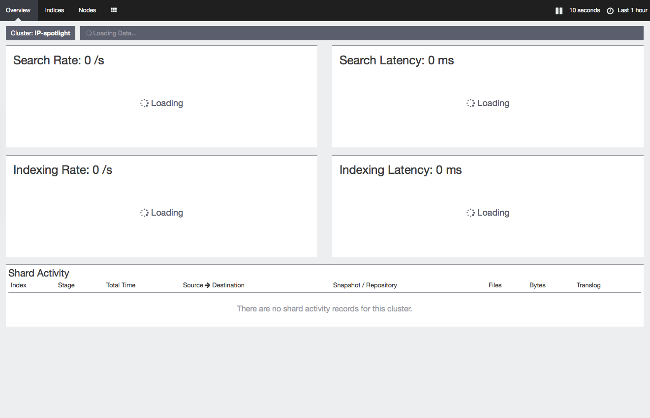

i recently installed Elasticsearch 2.0 and Marvel 2.0
i was experimenting with Curator and I accidentally delete the .marvel-es-YYY.MM.DD index
health status index           pri rep docs.count docs.deleted store.size pri.store.size
yellow open   .kibana           1   1          3            1     26.7kb         26.7kb
yellow open   .marvel-es-data   1   1          1            0      3.6kb          3.6kb
i have only 1 configuration change in elasticsearch.yml
marvel.agent.interval: 1m
but i cannot see any statistics on the marvel page because the corresponding index is simple not re-created, even waiting for 1 day to pass i cannot see the index created.
below are some screenshots from Kibana and Marvel.
could you please advise on how to troubleshoot this issue ?

Hi Nikos,
Did you configure marvel to index data locally or remotely using Http?
Unfortunately I wasn't able to reproduce your issue on my laptop. This is what I tested: I installed both ES 2.0 and Marvel 2.0 with default configuration (ie marvel indexes data in the same cluster being monitored).

Can you please check your logs to see if there is an error that can help us to find the issue?
Thanks

i deleted also the ".marvel-es-data" index as well, and re-install marvel also, but in vain.

I don't see anything strange in the log.
Can you please set Marvel to debug level? To do that, you need to edit the logging.yml file located in the elasticsearch config directory and add the line marvel: DEBUG under the logger entry:
logger:
  marvel: DEBUG
Then you can restart and wait few minutes so that Marvel will collect some data (it collects every minute with your config)

hmmm.. it seems that it doesn't even try to gather any data if i am not mistaken. any idea why ?
No... Can you try again but with TRACE level instead of DEBUG?
Hopefully we'll see something...

this pattern of log messages keeps repeating every 1min. now i got even more confused.

According to the trace, it works correctly. Every minute marvel collects a bunch of metrics and exports them locally ie on node nl-ams02c-ispdat01.
A curl -XGET 'http://<nl-ams02c-ispdat01 host>:9200/.marvel-es-2015*/_search should return some documents...
hmm.. no documents returned. can i ask how to completely delete Marvel ?
i did bin/plugin remove but re-installed it but didn't help..
To uninstall the marvel plugin, run bin/plugin remove marvel-agent. You'll need to delete the .marvel-es-* indices manually.
Then you can try to reinstall it again to see if it works better. Right now I can't say why it does not index data because everything looks good in traces and I did not manage to reproduce the issue.

Thanks for the proposal but what is the most helpful for me would be to debug locally and check line by line with source code what's going on.
Lastly, can you - still in DEBUG log level - update the sampling interval from 30 sec to 60 sec:
curl -XPUT localhost:9200/_cluster/settings -d '{"transient" : {"marvel.agent.interval" : "30s" }}'
Updating this setting may trigger index re creation.
hi @tanguy
i removed all plugins
i removed the .kibana index
i installed the new Kibana 4.2.1, Sense, Marvel
but i do not see the .marvel* indices created
i also applied the transient settings suggested but no luck.
Waiting for Marvel Data
It appears that we have not received any data for this cluster. Marvel data is sent every 10 seconds by the agent plugin; once the data appears this page will automatically redirect to the overview page.
and enabled logging in DEBUG mode, the output is :
cat /var/log/elasticsearch/*.log | grep -i marvel
- marvel
