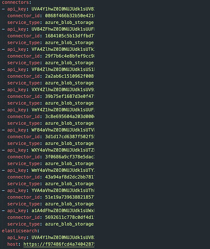

This is a snippet of my config.yml (truncated the ends)
I think my biggest query is, how many connectors should I host in a single container for Azure Blob Storage to Elasticsearch connection?
