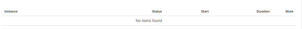

I am new to the Elasticstack in general and I have encountered a problem with creating an Alert using the Elasticsearch Query. I am using the index from metricbeat that indexes various processes of a host. From there I want the number of matches in the threshold to be below 1 so that the action is triggered whenever there is 0 match (meaning that the process is not working).
But this is not the case in my testing as when I stopped the host server to test the alert, the alert status would just change from active to ok with no instance of the alert to be found.
Could someone please help me with this problem? Thank you in advance!
