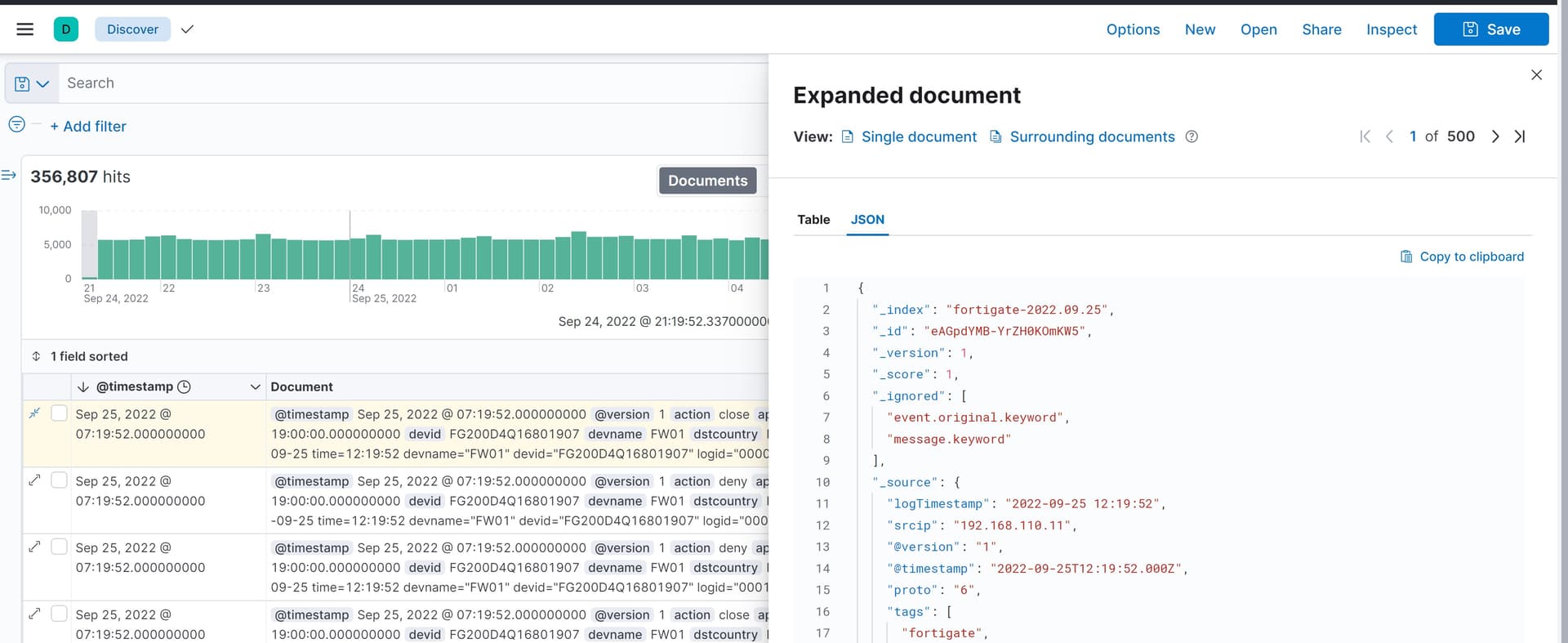

I have 1 logs stash server that host 8 end points, outputs to elasticsearch 6 of the index correctly log @timestamp in UTC and life is lovely two index @timestamp is in the local timezone. This is the time stamp shown in json form in kibana.
I am greatly confused as all 8 index work as expected on normal vm deployment with the same longstash config, but moving to k8 I did have to combine input and output into the same file and use multiple pipelines in the k8 vs multiple inputs and one output with one pipeline on normal vm.
please let me know what data to show that would help in seeking help.
