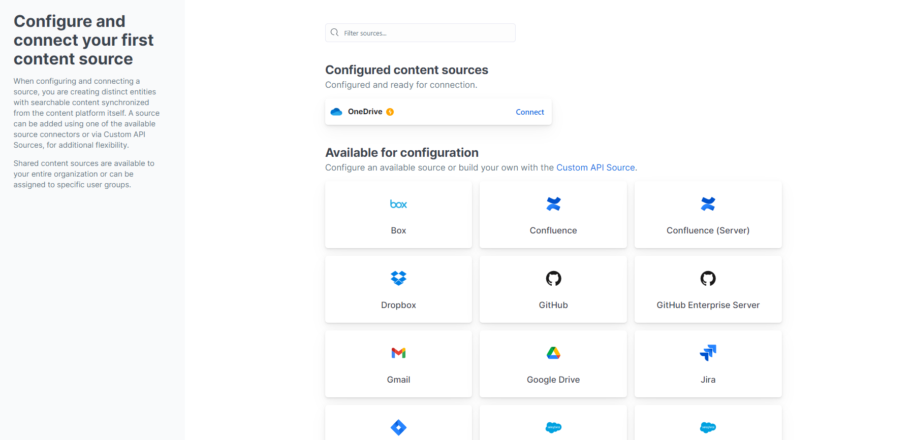

After i created the application in my azure portal, take the credentials and everything i need as suggested by this documentation: Connecting OneDrive | Workplace Search Guide [7.13] | Elastic
Im founding myself without been aple to complete the connection process. When i set up the configuration from , (Previusly assigned the application and client id to the conector)
After that i need to login in my microsoft account. After doing that i just get redirected to the main page with any change whatsoever
This is my redirect URL configuration in my azure app. Im using the URL as suggested by the documentation. Any idea on why im not able to connect and i just get redirected without any error message?

Just to be sure - in the last screenshot, when you click the "Connect" link beside OneDrive at the top of the page, it still goes through the same workflow you described?
