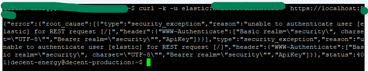

As you have enabled security could you please try below URL with user/password :
curl -k -u elastic:password https://localhost:9200

Thanks for helping and sorry for the delay in coming back to you. It worked fine after enabling security. I then got pulled into something else, came back to it a week later and could no longer get passed the issues described.
The only errors I can see are in elasticsearch.log
[o.e.h.n.Netty4HttpServerTransport] [decent-production] received plaintext http traffic on an https channel, closing connection Netty4HttpChannel{
[INFO ][o.e.x.s.a.RealmsAuthenticator] [decent-production] Authentication of [elastic] was terminated by realm [reserved] - failed to authenticate user [elastic]

If elastic pass is not OK, reset it with .\elasticsearch-reset-password
