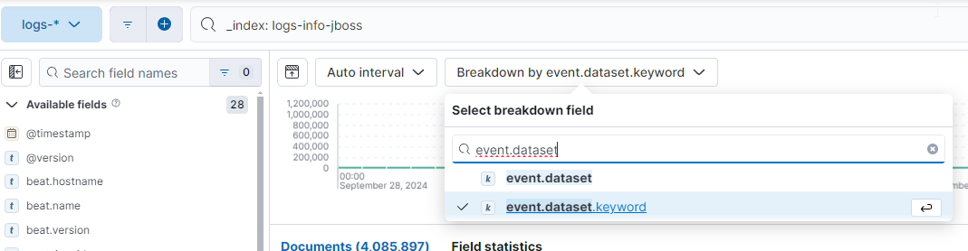

Hi Stephen
We upgraded to 8.15.2 - Same result
Could it be related to event.dataset typing?
What I noticed now is that event.dataset is a String field with keyword subfield.
Grouping options via discover:
Although still shown via discover as
keyword field:
keyword subfield:
String subfield:
Not possible to group on String field
I'll get back to you once tested with correct typed fields..

Hi @stephenb
It seems your last suggestion to debug via Discover did point me in the right direction!
Checking an item further in the past (dataset finally appears):
Timeframe we were checking (dataset is shown too together with other sources)
For completeness, my updated Component Template
(I'm disabling all_strings_to_keywords because keyword fields make searches harder)

CONCLUSION
event.dataset field was shown via Discover as Keyword field, although it was only a subtype on my system (primary type String)
Due to incorrect (primary) type, Log rate per minute tile on the Observability Overview screen did not pick up the event.dataset field
Same solution would have probably worked on 8.14.3, but system was already upgraded to 8.15.2
Thanks a lot for your persistence!
