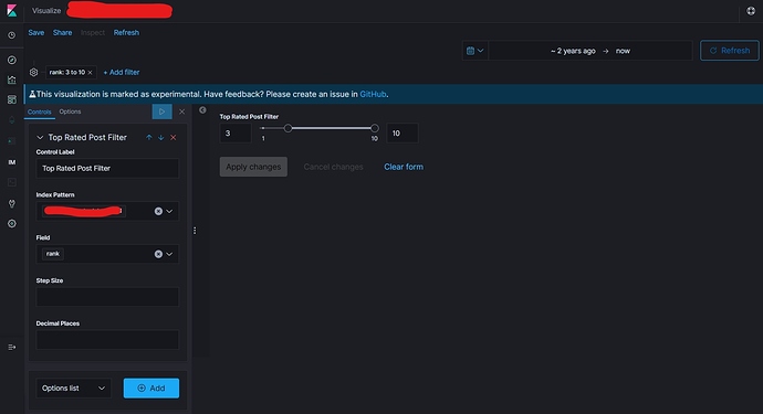

Range slider control button doesn't work in the visualization

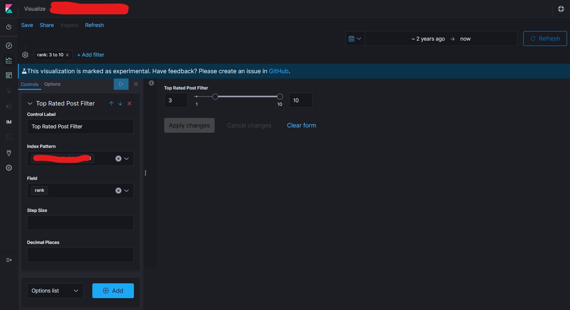

Hi, everyone. I'm trying to create a dashboard and I need to create a control button (range slider) first. When I'm trying to create and run the control button, I realized that there is not any output. As you see in the pictures below, there is no output.
What should I do? Is there any solution about this?
The input control vis is special - it's not displaying any data, it's just configuring filters for other visualizations. As long as you are configuring it in Visualize, there are not other visualizations, so it's not actually doing anything. Save it and add it to a dashboard, then the other visualizations are filtered down by the changes you are making.
