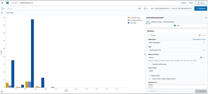

{ "min_doc_count":1} didn't work.
As I understand correctly, for your case presented on the screenshot you wouldn't like to display months from Jul to Dec because they are empty? Unfortunately the chart you're using is a Date histogram and it is impossible to do that over time.
any other solution instead of a Date histogram? I split data using some filters and I want to show it according to Months.

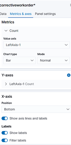

Thanks for the solution.. unfortunately, this didn't work..
Hmmm, could you paste your configuration screenshot here? Does scripted field return the correct value?
