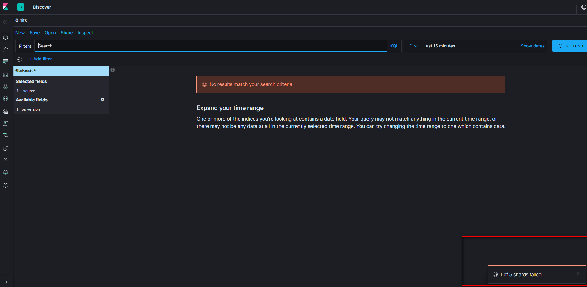

Anyone can you help me? Below codes were from my ELK Version: 6.3.2 and everything works fine before. But, when I've upgraded this week to 7.2 these code not working as expected.

I updated just kibana from 6.3.0 to 6.3.2 (I readed on support matrix and this is the latest "minor" version compatible with ELK 6.3.0), but it did not solve the problem. the behavior is the same as the previous version 6.3.0.
Sometimes, the expression doc['my-field'].value seems to be null.
I just thought it was a Kibana bug but probably it's related to ELK 6.3.0 (6.3.2 stack works for @mark.quilates )
