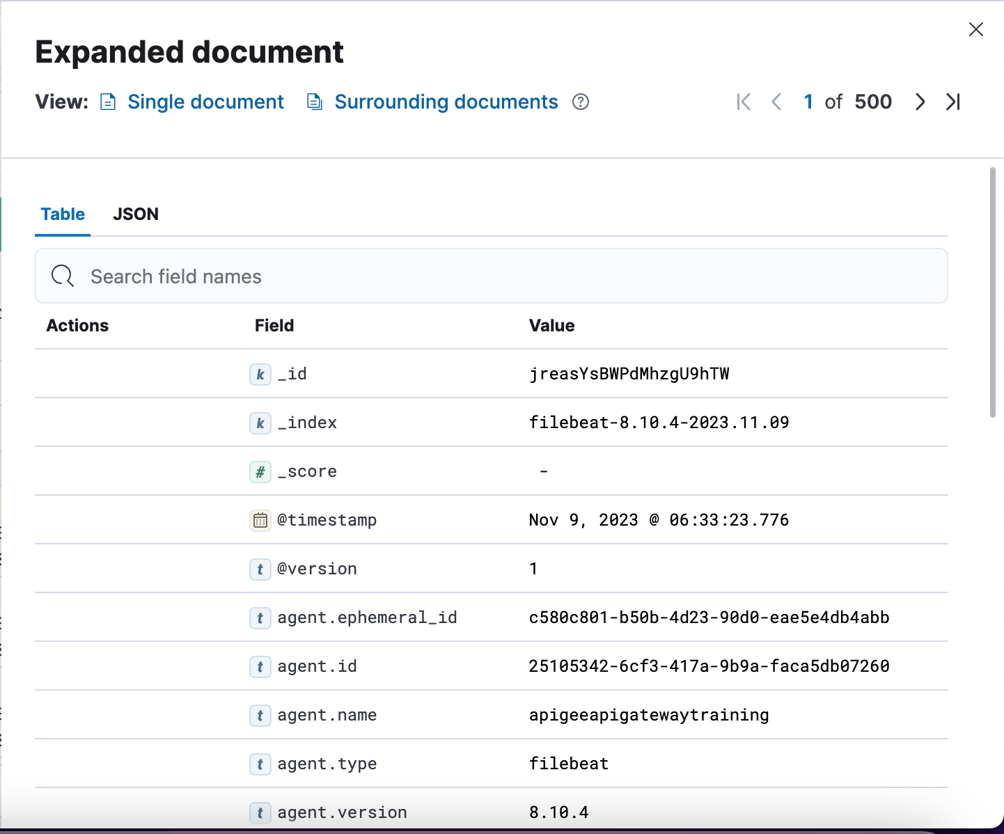

@stephenb Thank you for your response. I am attaching the screenshot for your reference.
Please refer to the below JSON output for one of the document.

Hi @kaushalshriyan Good information
BUT the sample Document you gave looks like filebeat log so that field / text does not exist.
The other things is that you have not parse your logs so the entire log ends up in a field called message
In general, you would parse your logs with 1 of 3 Ways
  1. They are of a known type that a filebeat module support
  2. You would parse with logstash filters Grok etc
  3. You would parse with an ingest pipeline
Otherwise, you whole log will just stay in the message field
You also need to learn the difference between keyword field (exact match) and a text field which is full text search
If the message field is a type text or match_only_text
In Dev Tools run
GET filebeat-8.10.4-2023.11.09_mapping/field/message
In discover try
message : "b014415c-1795-46e5-8585-e65ed31c5a81"
