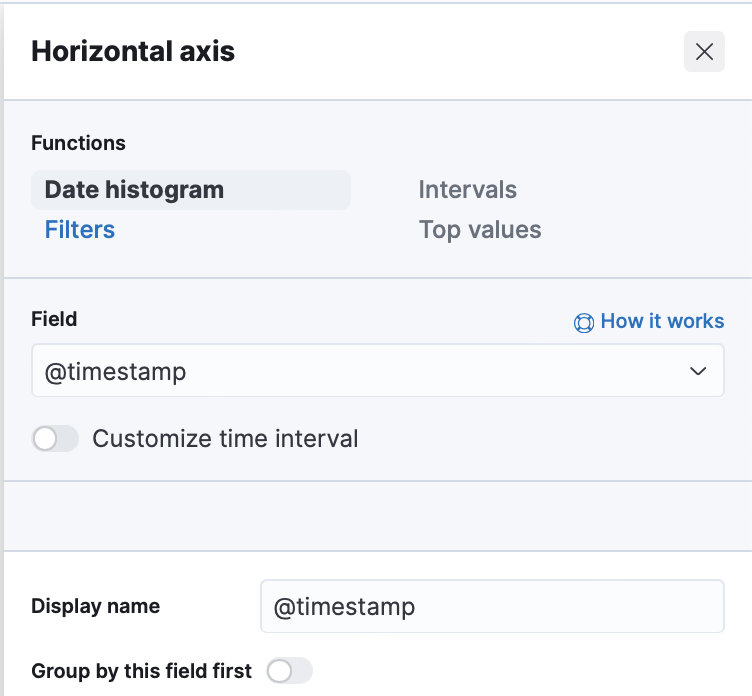

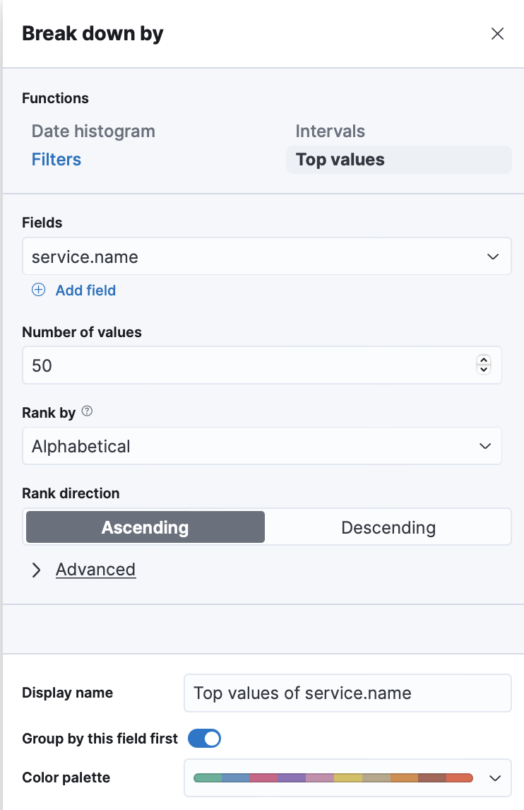

We have created a lens visualization for showing the apdex score of APM traces and we would like to create an alert based on that score. Our knowledge in alerting and monitoring is still limited and we haven't found a solution to transform that in an alert.
I attach an image of the visualization:
And here is some extra info from the visualization:
If the score goes under 0.8 then it should trigger an alert.

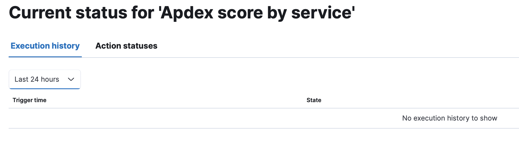

Hi @richcollier
I made some changes to your watcher example but I think something seems to be failing.
This is my _watcher post

The simulate is working and sends the notifications to an slack channel. But when I save it I don't receive more notifications. Why could it be?

I know it doesn't make sense. I included log along with slack action but it doesn't work. It just works when I do a simulation. :man_shrugging:
I include some screenshots from the watcher.
