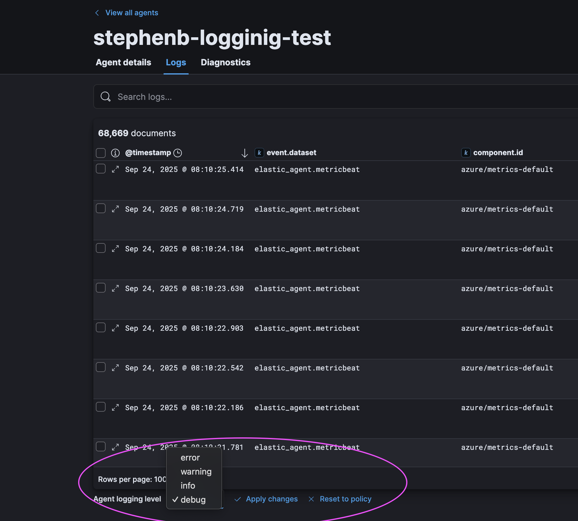

On the agent host, there's a directory called events under the logs. Did you check in there because that's where it'll show issues with actually sending the data.
Please look in there, and if you share the logs, please don't use jq or similar tools to parse them, please take a look for errors and share those events in raw form.
Example
/opt/Elastic/Agent/data/elastic-agent-9.2.0-SNAPSHOT-c4b645/logs/events
Can you stop and start the agent and then share a full latest one of the regular logs (not in event directory)
Quick glance of event log just shared, there is no reference to that log file at all that you're trying to harvest.
So that leads me to indicate that failing to access that path or something like that.
Assuming you checked basic things like permissions reading the file....
How many lines are you added to the file ... just 1? 100s?
If you only add 1 line and do not add a newline it will not read it.

Looked through .. .do not see any messages about that filestream collector at all... not sure what to tell you. I would turn up the Log Level to DEBUG which it is not.. do you know where to do that? Its kinda hidden
Do that then look through all the logs again...
With debug you should see it start the collector for that file...
I would turn off everything else if you can to isolate but that is up to you....

Hi, I couldn't find the debug logs, but I created a new integration policy and tried reading the same log file. I encountered the same issue, but when I ran the following command, the log appeared.
