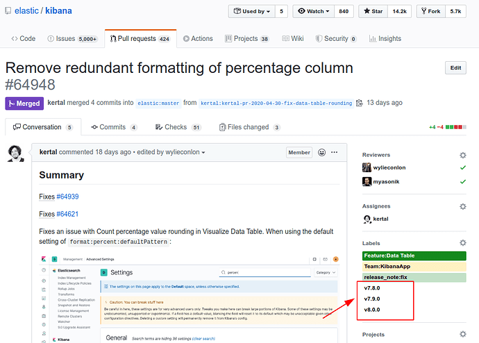

We recently fixed this bug in this PR https://github.com/elastic/kibana/pull/64948

This is not fixed in 7.7.x - it will be fixed with the 7.8.0 release:
I hope you can wait that long - the work around is not to use the Spanish locale.
