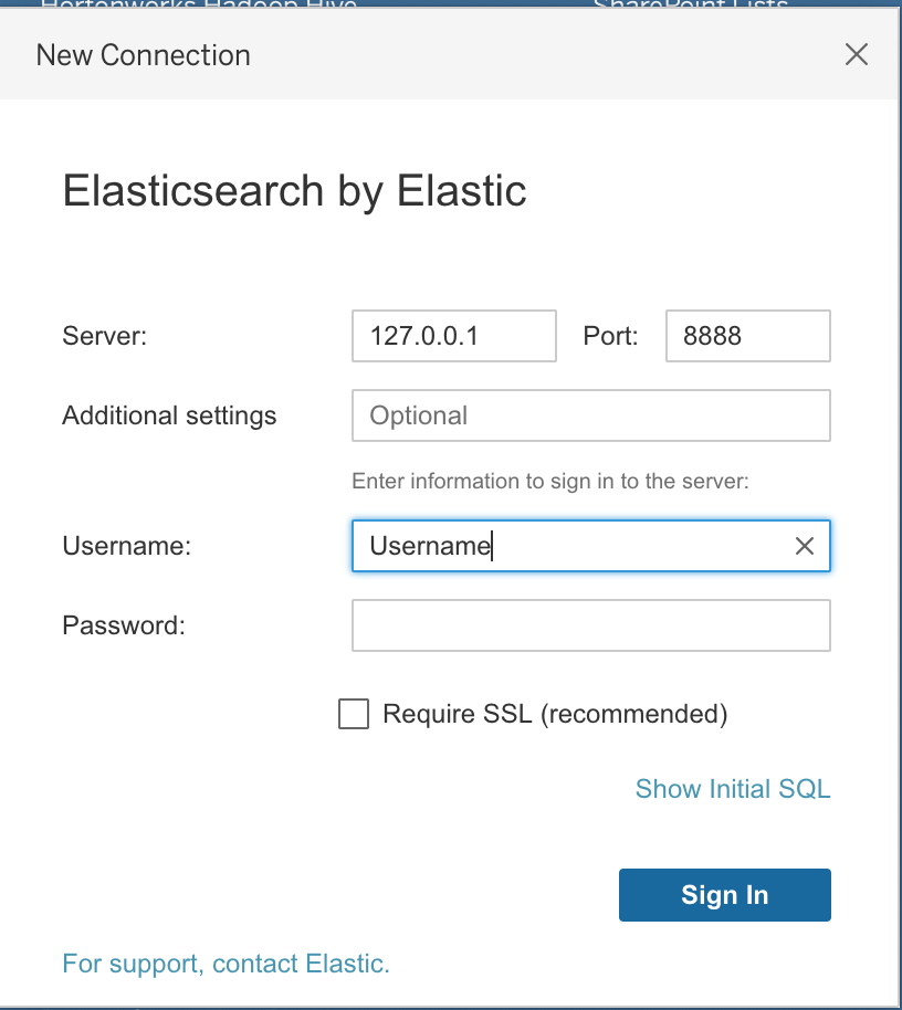

Once I have established the SSH tunnel between my laptop and the VM where ElasticSearch server is hosted, I launch Tableau and select the connector "ElasticSearch by Elastic JDBC connector"
I then fill the requested areas, the server address being the localhost address I would use to check ES on my browser  (the port being the listening post used for the SSH tunnel)
If the connection between ES and Tableau works (or at least seems to), I can't see any of the data or table I should be seeing.
Is there anything I am missing or doing wrong?
