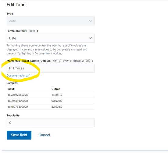

Thank you for the response. Could you answer me if the time field as highlighted below in anomaly explorer can be formatted in some way. I would like it to show just the time and not the date.
I formatted the field in the index pattern as highlighted below to just show time but it seems not to work in machine learning.
Thank you
Regards
Hi,
I'm afraid it is not possible to change the format of the time in that table.
There is additional logic in the choice of the formatter based on the interval of the data which means we can't use the built in Kibana format pattern.
James
