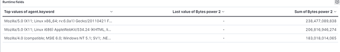

In a lens table, I try to find the last value of bytesSquare for top agent.name and I don't get expected results:
  1. image
  2. image
This works with scripted fields but not with runtime fields. I'm I going wrong anywhere?

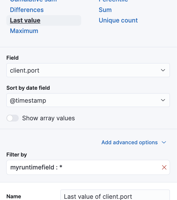

Try filtering the lens metrics for where your runtime field has a value. sometimes the nulls can trip up the last value operation. So much so that we add this metric filter by default in version 8.2
