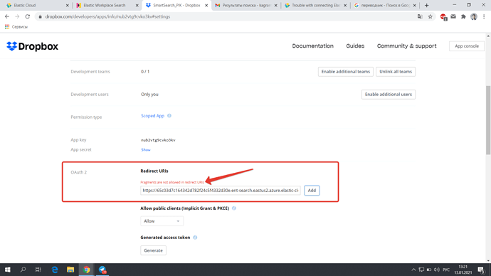

Now i have one trouble with connecting ElasticSearh and Dropbox.
I don`t understand what is need to be input in this window.
image (4)
I also can not understand this explanation:
Сan you please help me with this case?

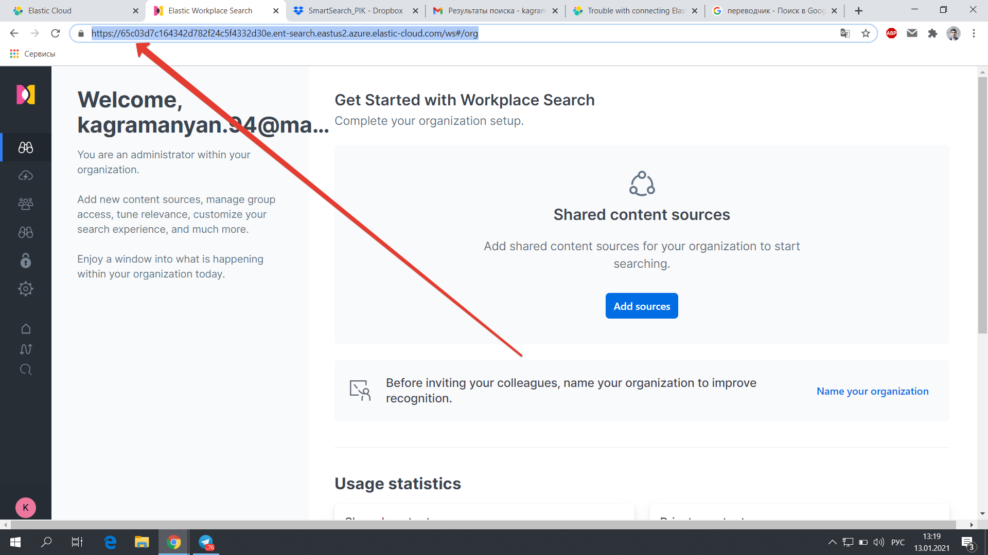

Where's your workplace search instance running? What is its url?
I don`t know.
How can i find out?
When you login to Workplace Search, you have to enter the URL in your browser. If you launched via Elastic Cloud and you just clicked a link to go to Workplace Search, you can grab the hostname from your browser's URL bar.
I launch via Elastic Cloud and I just click a link to go to Workplace Search.
Would i grab this hostname from my browser's URL bar?
In this case, the following error appears
@avetik thanks for the screenshots, I can see what's going wrong.
I think you've misunderstood what a "hostname" is, and how to get it from a URL. You can read about the various parts of a URL here in the wikipedia article. In our dropbox documentation, in Step 5, we specify:
Within OAuth 2 and Redirect URIs, add the following two redirect URIs, substituting <WS_BASE_URL> with the base URL at which Workplace Search is hosted (scheme + host, no path).
<WS_BASE_URL>/ws/org/sources/dropbox/create
<WS_BASE_URL>/ws/sources/dropbox/create
Examples:
# Deployment using a custom domain name
https://www.example.com/ws/org/sources/dropbox/create
https://www.example.com/ws/sources/dropbox/create
# Deployment using a default Elastic Cloud domain name
https://8905d44eb30e4d56a1acc41bde14c847.ent-search.us-east-1.aws.cloud.es.io/ws/org/sources/dropbox/create
https://8905d44eb30e4d56a1acc41bde14c847.ent-search.us-east-1.aws.cloud.es.io/ws/sources/dropbox/create
The key bit there is (scheme + host, no path). From the error that Dropbox is giving, it looks like you've included the "path", which in this case would have been /ws#/org.
Let us know if you run into other issues. :slight_smile:
