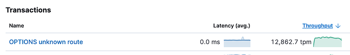

Some application has many 'OPTIONS unknown route' calls in you trace and this calls mask the APM values. I tried to use de transaction_ignore_urls with regex, only to test, but as I thought, it didn't work.

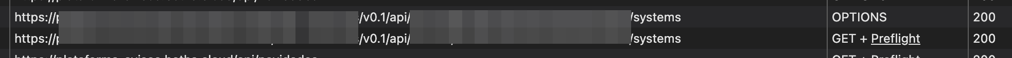

I'm experiencing "an issue" with CORS preflight requests from our frontend to the backend API. The browser sends an OPTIONS request before the actual API call.
For reasons I have not yet determined, we are seeing a very high volume of these OPTIONS requests, as I described in the previous thread.
My concern is about the 'OPTIONS unknown route' trace. I don't understand why these calls appear in APM and what the source of the problem might be (if it is, in fact, a problem).
A direct consequence is that these requests are triggering false positive high-throughput alerts in our monitoring system.

This is the browser call:
What is causing the traces to appear as 'OPTIONS unknown route'? Is there a way to fix this? For example, is there a specific setting in the agent configuration that can prevent these traces from being captured?
