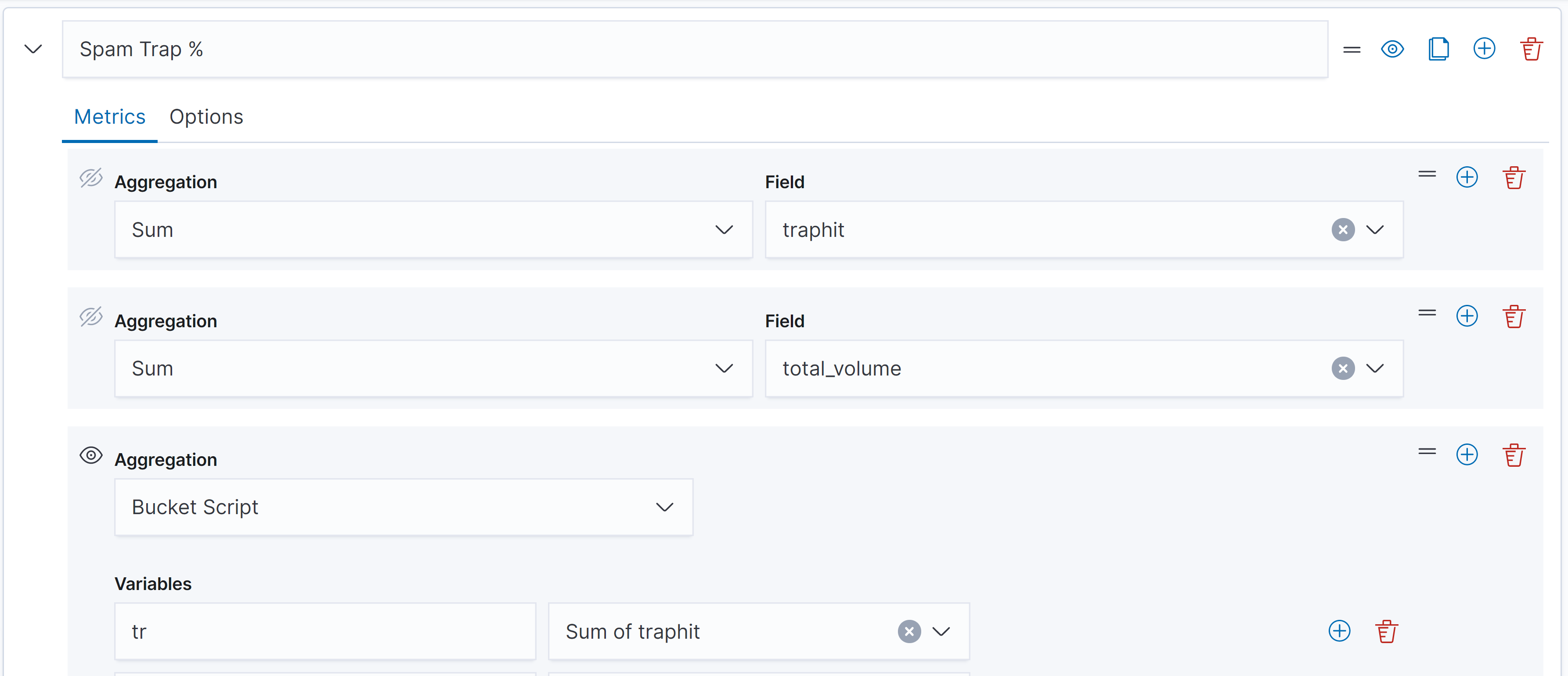

I set up a data table using TSVB. The data table includes total numbers as well as ratios, please see the screenshot:
The ratios are based on bucket scripts using aggregations:
As last column I am trying to add the ratio from total_volume which includes a specific string. So I assumed to put a filter ratio into one of the bucket script params:

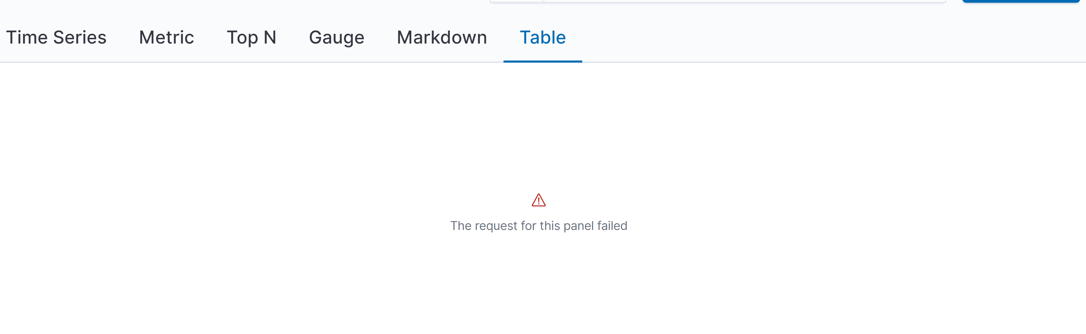

But it breaks the table panel:
What am I doing wrong here? Thanks for your help.
Hi, it looks like this is a bug in TSVB. I tried reproducing a Filter Ratio column using a sum aggregation on a numeric field, and got the same result.
Unfortunately the error is buried in the JavaScript developer console:
The highlighted [object Object] part means that data is not serialized properly for the request.
Looks like you did nothing wrong here. Filed this bug: https://github.com/elastic/kibana/issues/82067
