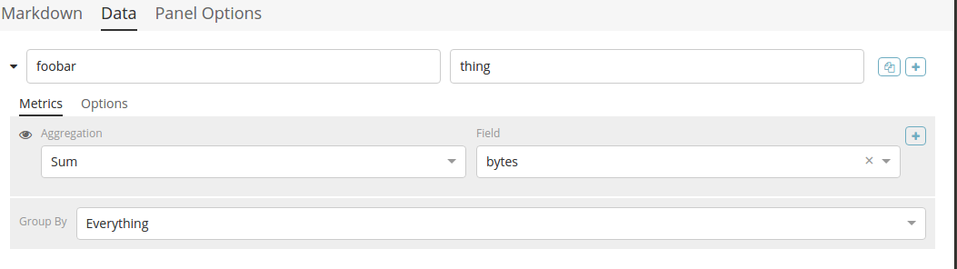

hi @slashdoom,
interesting.
Without having access to your data, it's difficult to reproduce, but can you try the following?
  1. instead of setting the filter as a 'Filter' in the group by, can you make it a panel filter. e.g.:
Do "Group by" everything in the markdown
  1. can you also try naming your variables, and then when you cycle, access it by variable name.
{{#each foobar.thing.data.formatted}}
 - {{[0]}}, {{[1]}}
{{/each}}
I am curious to see if you get the exact same behavior and values in the output, or not.
thx,
Still looks like I'm getting the same value at each point with the changes you recommended...
