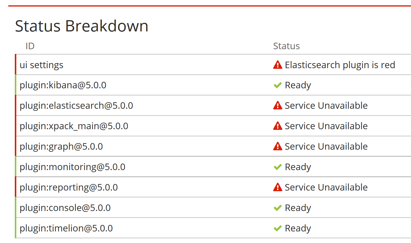

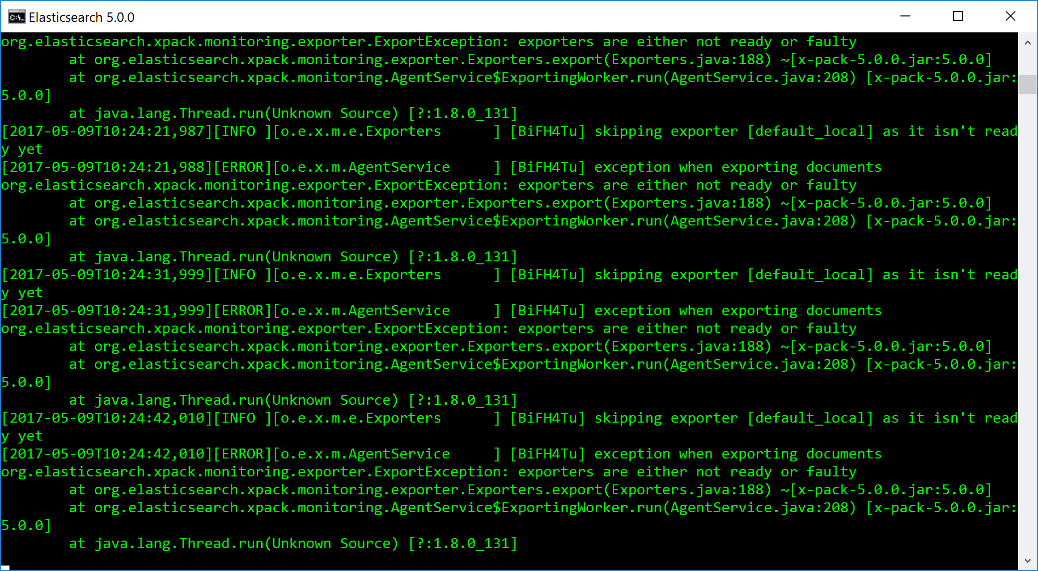

anyway, I have some errors when run Elasticsearch:
and, the Status Breakdown from Kibana change to below figure:
Anything that I missed?
Thank You.
