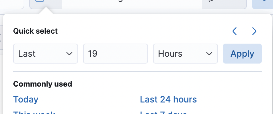

Hey there, sorry for the delay in responding. What do you mean the data is not correct? If you need a full day, you can just click on 'today' in the timepicker:
Also time:(from:now%2Fd,to:now%2Fd)) works fine for me. Please let me know how you validate the data is not correct.
