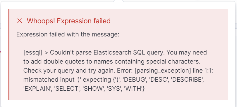

Exception
Expression failed with the message:
[essql] > Couldn't parse Elasticsearch SQL query. You may need to add double quotes to names containing special characters. Check your query and try again. Error: [parsing_exception] line 1:1: mismatched input ')' expecting {'(', 'DEBUG', 'DESC', 'DESCRIBE', 'EXPLAIN', 'SELECT', 'SHOW', 'SYS', 'WITH'}
Work continues but wanted to give an update as to where I'm at.

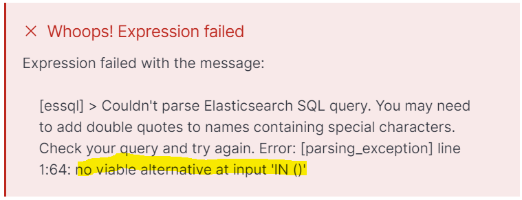

Running it gives the following error

Tried this and getting something new
Looks like the inner query from filebeat-response is not returning any results?
