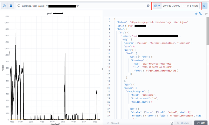

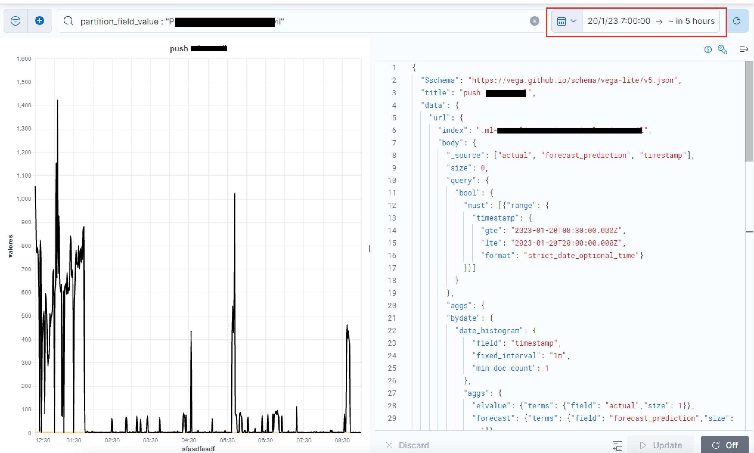

This is my current vega lite code (index field and partition_field_value have been modified due to are sensible information)
  • As I removed "%context%": true and "%timefield%": "timestamp" under URL, time filter doesn't works and it's defined the datetime under query - bool ...
  "$schema": "https://vega.github.io/schema/vega-lite/v5.json",
  "title": "push notifications",
  "data": {
    "url": {
      "index": ".ml-anomalies-cxx-xxx_xxx_xxx_movil",
      "body": {
        "_source": ["actual", "forecast_prediction", "timestamp"],
        "size": 0,
        "query": {
          "bool": {
            "must": [{"range": {
              "timestamp": {
                "gte": "2023-01-20T00:30:00.000Z",
                "lte": "2023-01-20T20:00:00.000Z",
                "format": "strict_date_optional_time"}
        "aggs": {
        "bydate": {
          "date_histogram": {
              "field": "timestamp",
              "fixed_interval": "1m",
              "min_doc_count": 1
            "aggs": {
              "elvalue": {"terms": {"field": "actual","size": 1}},
              "forecast": {"terms": {"field": "forecast_prediction","size": 1}}
    }, "format": {"property": "aggregations.bydate.buckets"}
  "enconding": {
    "x": {
      "axis": {"format": "hoursminutes"},
      "field": "key",
      "title": "asdf",
      "type": "temporal"
  "transform": [
    {"flatten": ["elvalue.buckets"],"as": ["currentvalue"]},
    {"flatten": ["forecast.buckets"],"as": ["futurvalue"]}
  "layer": [
      "mark": {
        "interpolate": "monotone",
        "opacity": 0.5,
        "tooltip": true,
        "type": "line"
      "encoding": {
        "color": {
           "type": "point", "value": "orange"},
        "y": {
          "field": "futurvalue.key",
          "type": "quantitative"
        "x": {
          "field": "key",
          "format": "hoursminutes",
          "title": "sfasdfasdf",
          "type": "temporal"
        "tooltip": [
          {"field":"key", "type": "temporal", "format": "%d/%m/%y %H:%M", "title": "fecha"},
          {"field":"futurvalue.key", "type": "quantitative", "format": ",.2r", "title": "valor forecast"}
      "mark": {
        "opacity": 1,
        "tooltip": true,
        "type": "line"
      "encoding": {
        "color": {
           "type": "point", "value": "black"},
        "y": {
          "field": "currentvalue.key",
          "title": "valores"
        "x": {
          "field": "key",
          "title": "",
          "type": "temporal"
        "tooltip": [
          {"field":"currentvalue.key", "type": "quantitative", "format": ",.2r", "title": "valor_actual"}
What I'm doing wrong? or isn't possible to create a graphic with forecast data on vega-lite?

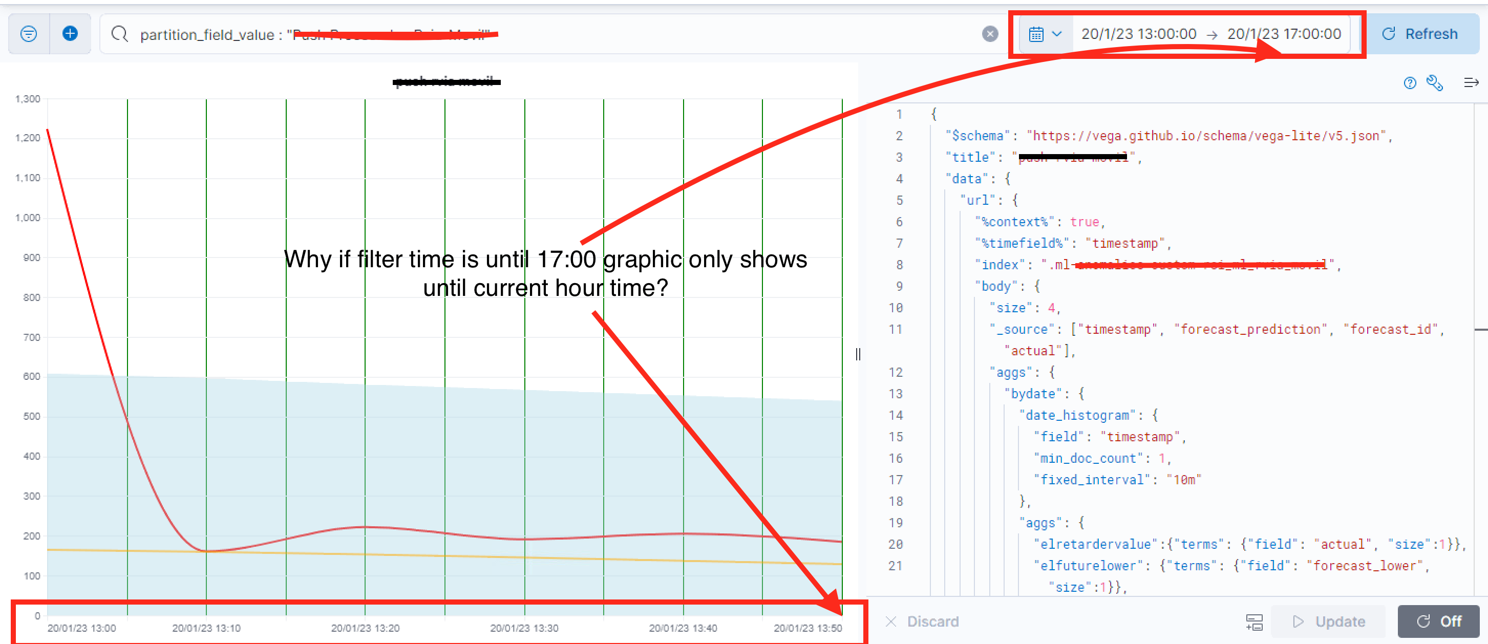

Hello I would to add more information, as you can see the response of query shows data 3 hours next the current time.
why if response shows the forecast values, example on "key_as_string": "2023-01-20T16:00:00.000Z",, these data is not printed on the graphic?

Thanks for your help
Hello, anyone could help me? Thanks
Hi @plus
welcome to the Kibana community.
in Lens when a time shift is enabled, there's a response manipulation on top of the raw ES response, what is probably why it's not that easy to reproduce in Vega lite.
But could there a way to reproduce in vega lite? Do you know someone whom could help me to deploy it? Thanks
Good morning @Marco_Liberati do you have any update if is possible to do this forecast visualization with VegaLite?
Thanks.
any update? thanks
Hi @plus
will have a look at this next week as it's not trivial and requires some time to re-align the shifted data in Vega via transforms.
