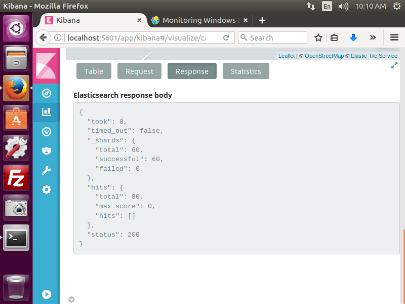

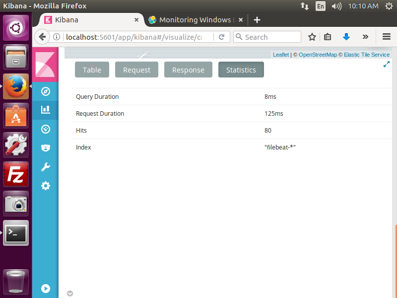

I clicked on the down arrow, but I don't know what the 80 count means.
The Request screenshot:
The Response screenshot:
The Statistics screenshot:

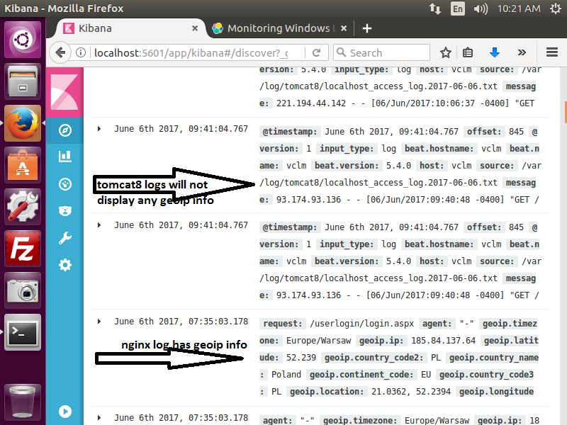

Geoip.location:
Log info:

Did you click the :arrow_forward: button at the top to apply the geo hash aggregation? The request and response show no indication that a geohash aggregation has been applied.
Thanks, I now know what to look for in the Response tab. Apparently the Apply Block in the Youtube videos has been changed to the :arrow_forward: button at the top.
