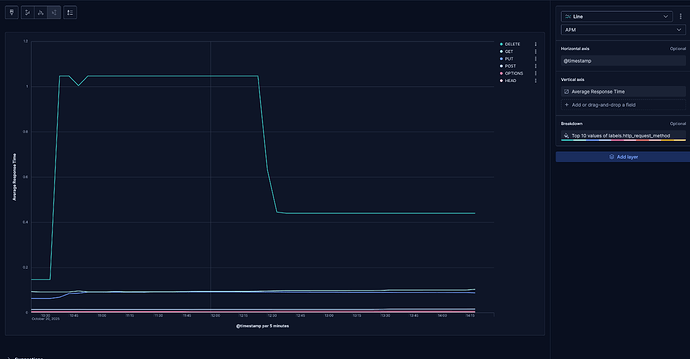

We are using Kibana 9.1.2. I do see the option to chart it. So does Kibana automatically detect this is a histogram and if I use a function like Average or Count it will automatically know how to process the histogram to get a correct visualization from it?
What I’m seeing in this data doesn’t appear to match the pattern I’d expect from other APM trace data. For example, this is should show average response time by HTTP method for the last 4 hours. But the latency APM graph shows a large spike at a later, different time of about 30 seconds. I see something similar for count of http.server.request.duration and the throughput APM metric not matching.

Yes it should.
I am not sure what you are comparing that to on the bottom.
Many times when I see things like this it s because the graph is not properly filtered and / or broken down.. like by service or environment or transactions etc. .. the results are different dataset being erroneously aggregated together.
Are all the exact same filters applied...
There are different ways to calculate the latency... see here
It is not clear to me that you are comparing like for like.
I think I gave examples here
