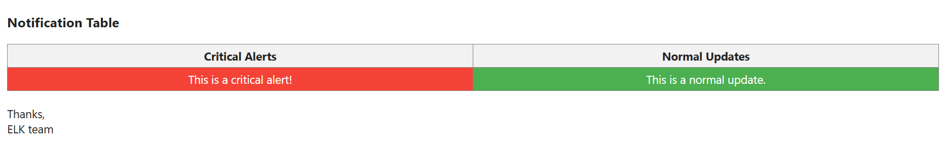

elasticsearch.yml setting :
xpack.notification.email.html.sanitization.enabled : false
Sample email received :
If i remove the above entry from elasticsearch.yml :
Thanks!!
You need to add _styles to your 'allow' setting as documented here.
Thanks @angelo for the suggestion.
Using styles , i confirm it is working as expected.
xpack.notification.email.html.sanitization.allow: _tables, _formatting, _styles
Thanks!!
