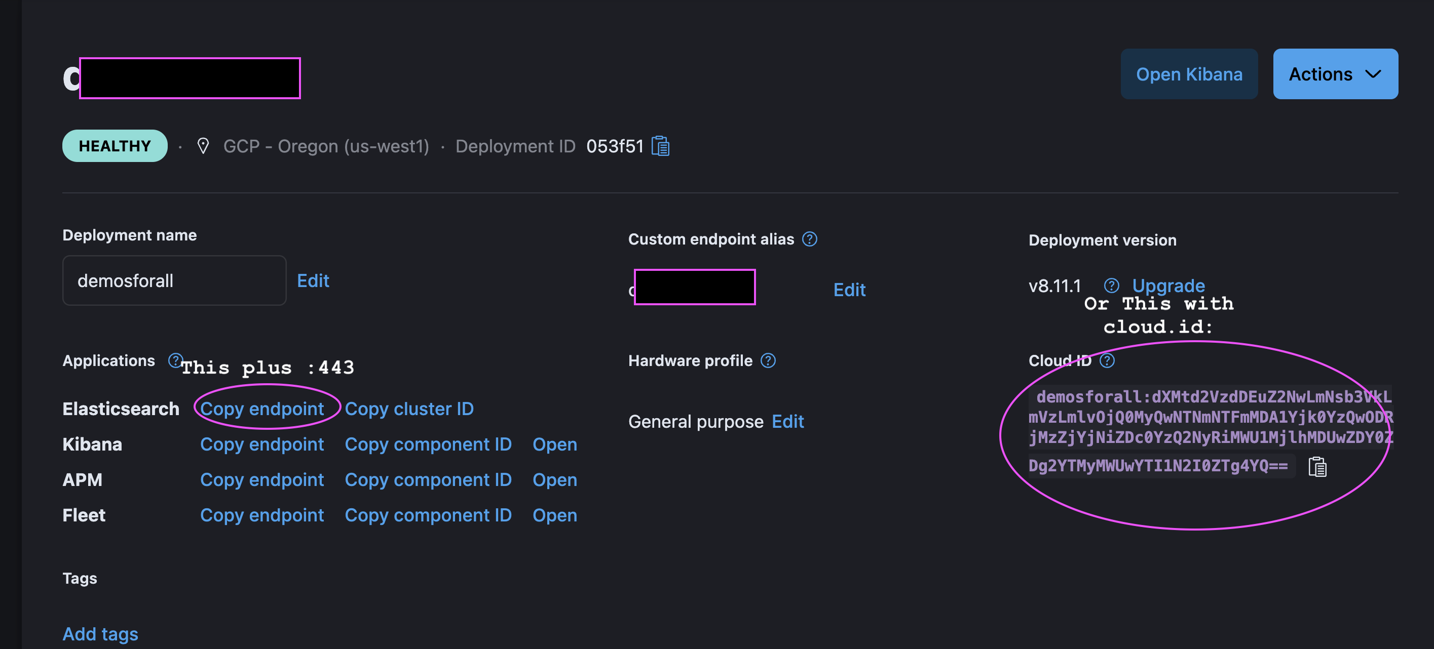

I do not use Elastic Cloud, but if I'm not wrong this endpoint is for Kibana, it as a kb , you need to use the endpoint to Elasticsearch.
I think you just need to replace the kb by es.

That is correct... BUT you need to add the port :443 otherwise it will default to 9200, which is not correct (that should be in the docs)
https://jcc-firstdeployment.es.us-central1.gcp.cloud.es.io:443
cloud.id will work as is
Looks like that might have done it, thank you.
