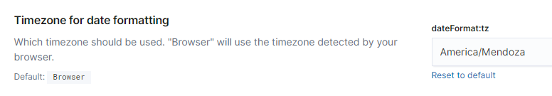

I can not properly set time on my kibana web.
As you can see on picture bellow , timestamp on kibana and timestamp on elasticsearch returned document has a 3 hours difference.

I already set timezone on kibana config.
Dont know what else to do.

If you set your timezone in kibana to browser and you are running it from a machine in the UTC - 3, your time is correct in Kibana, dates stored in elasticsearch are always in UTC.
You say that this time is correct.
"timestamp" : "2020-09-26T11:42:44Z"
This is in UTC, it will show up in Kibana as 2020-09-26 08:42:44 for a browser in the UTC - 3 timezone, which seems to be your case since you are using Mendonza time in Kibana.
Looking at your example script you are setting your local time which is UTC - 3 as UTC.
I'm also on a UTC - 3 and running date in my system gives me the following timestamp:
sáb set 26 12:29:55 -03 2020
This time in UTC should be 15:29:55, that it is what should be ingested in elasticsearch.
Running your script would set this date to:
2020-09-26T12:29:55Z
This is 09:29:55 in UTC - 3.
