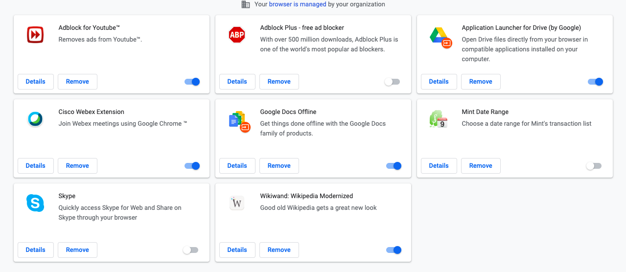

That page loaded for me in Chrome. Do you have any security settings set in Chrome? Is a Chrome Extension causing it? I would try opening in an incognito window.
Wow. You solved it. Incognito mode worked as well as Safari.
I have ad blocker, but had it turned off. I guess I will go through the rest of these extensions and see which is blocking it:
Figured out this was firewall issue. Apparently in Europe it is common to close ports in the outbound issue because of the gdpr privacy laws.
