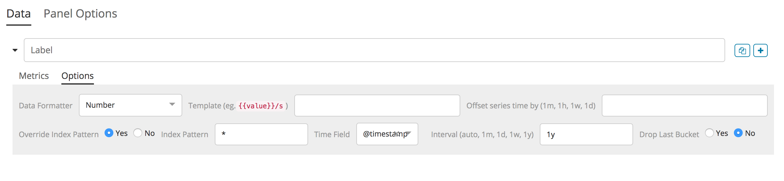

However, I have found a way around this limitation that may suit your purposes. If you change the bucket size to something very large, you can grab these max values and perform a calculation on the result.
To do this, in Options under Data, select yes to Override Index Pattern and make the interval something large. I made mine one year. Be sure to also check No on Drop last bucket.
You'll need to also go into Panel Options and check No for Drop last bucket there as well. For some reason, auto as an interval works fine for me here.
Then you should be able to add Max and Min aggregations, and the value won't be 0. Then you can run a calculation over those values, and hopefully get the number you are looking for.
